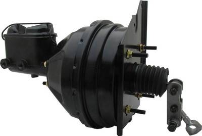

About to purchase a Piratejack Booster and Master. Just wondering if anyone has used them? The Right Stuff Detailing booster has stopped working and its the second one that I know of that has failed. If you go read the reviews on Summit about the RSD none of the reviews are good. Same problem I have had with them. Anyhow the Pirate Jack one looks good and looks more correct for the car. Just wanted to know if anyone has installed one.
Looking at this setup.
Bendix Style Mopar 1966-1970 B Body Power Brake Booster Conversion Kit BCK8536-1 OEM Style for 1966-70 Charger, GTX, Road Runner, Satellite
Can't help with the whole unit, or the booster but I had booster Dewey redo my OEM Bendix booster on my coronet 25 years ago...and it's still working today and I just replaced my original OEM Bendix master with one of the reproduction units, probably the same one on this kit.

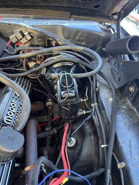

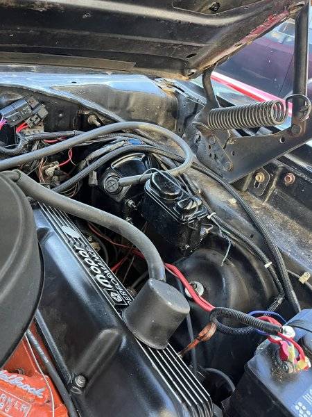

Installed the Pirate Jack stuff today. Man that was the difference... Now have boosted brakes again. The Right stuff booster failed internally. When you push the fulcrum the side that goes into the master doesn't move. I do need to move the brake light switch bracket now to get it closer to the new peddle. But man night and day difference and looks a **** ton better with no wiggle like those offset deals. Still have to add the rear brake line adjustable prop valve but.. That's coming next.
Make sure you have the push rod from the booster to master cylinder adjusted right, don’t ask me how I found out about that!
I got the booster only about 5 months ago and it went in nice.
Did you have to set the booster pin rod to master or is it preset. I'm asking because I bought the reproduction kit & I'm having brake problems on my 68 charger. I'm not even sure if this booster rod can be set. I tried turning it but it didn't seem to make a difference. I bought the mbm brand from classic industries. So it should be a bolt on ready to go setup right? I tried to add a photo but apparently it's too big.
the truth is I did NOT and when I was done I took it to a guy that knows way more than I do and he was concerned about it even though the brakes were operating perfectly so we disassembled it to check it and it was set exactly where it needed to be so we put it back together and all is still fine.
