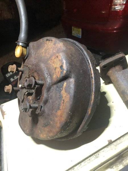

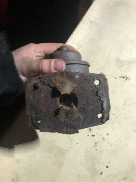

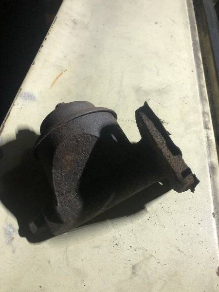

I took the brake booster and master cylinder off of my 1966 Dodge Coronet 440 and I’m looking to buy a brand new booster and master cylinder. After some research I found that my booster is a 1971 bendix booster and I can’t find a new oem replacement for it. I’d prefer to keep the single reservoir with the single brake line so I don’t have to replace my brake lines. Car has drums all around. Does anyone have any suggestions on what I should buy? Do universal boosters work with the factory style master cylinder? I would prefer to not make any modifications to the car. I’m open to buying a new 1966 style booster replacement. Any help is appreciated.
This is THE perfect time to get rid of the crappy deathpot master cylinder.
PST is a sponsor of this site and has just what you need. The brake line changes you'll need to make are a great idea anyway. Look at the condition of your old master cylinder. Your brake lines may look just as bad inside. Inline tube and other vendors can get you what you need. Lines for a 1968-70 model will be the correct length.

I totally agree, actually ANYTIME is the perfect time to get rid of that single reservoir/single line set up. Even brand new, that set up is a ticking time bomb. It's a good thing that thing died before it had a chance to kill you or someone else. I lost brakes in a '57 Plymouth not too many years ago and that was a bit scary. Saved the car and got it stopped safely. I also had a similar situation while driving a friend's '64 Impala SS 4spd convertible a few years back. That one was way more frightening. I never want to go through that again.
Please upgrade to a dual reservoir system. I can not stress that enough! Best of luck to you!

Looking at the condition of the MC and booster, you should seriously consider replacing anything and everything that is any part of the braking system,
