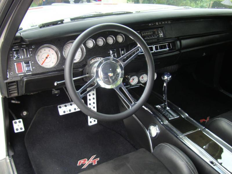

I'm put a B&M Quicksilver in mine but am using a custom console (69 Charger), the console is pretty much the same size as the original. I will mention for me I ditched the factory supplied 5ft cable in favor of a 4ft to keep the cable away from the exhaust. I made an aluminum cover to go over the factory shifter linkage hole and then put a rubber boot to seal it off. I think I might have moved the shifter back from where it is supposed to be so that may not work for yours, just keep it as straight as possible with no sharp bends.

I put a B&M Quicksilver in my 69 charger. Had to do some minor trimming but nothing majorconsole 0211.jpg
Got pictures of the cable running under the car and the trans hook up?
Very nice...........

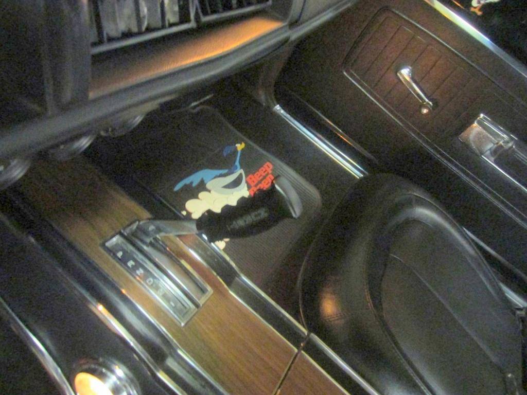

Decided on, purchased and installed a Duncan Motor Sports Shift-R-Arm. Hurst grip is temporary. Have a Custom wood grip being made by idle Hands Woodwork. Oak center with Tiger Maple Grips.......will post a couple photos when completed.
http://idlehandswoodwork.com/
I have the Duncan shifter now too. It's great just don't like exactly how the gate is set up. Love the ratcheting action of the pro matic. Just need to see who else if anyone has done this mod on a factory console automatic! Lol
The photos of the Charger with the Pro Matic 2 that I posted above...the owner had to remove the stock shifter mounting to get the Pro Matic to fit and work correctly....that was the main reason why I went with the Duncan.......am not racing but I just wanted something different. Try doing a search on this forum for a Pro-Matic II conversion....should be able to find the posting and send a PM to that member for more info on the install.
