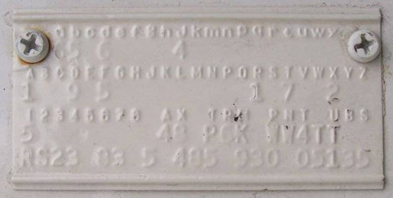

Stripes on a 67 GTX are coded under the PNT code such as the picture below.

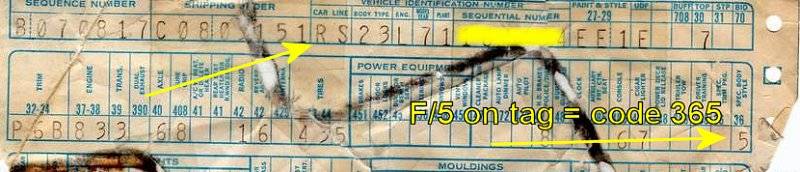

'67 F/5 = sales code 365 = GTX 'package' if you will.
