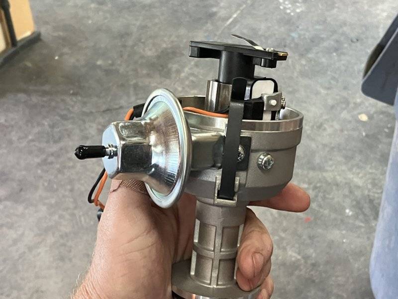

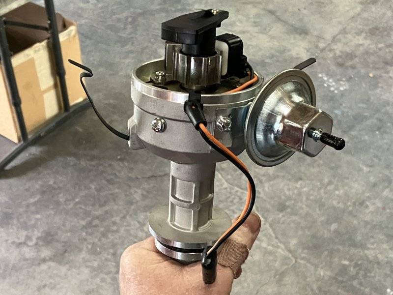

This is one option. I already have it in the shop on a shelf.If you are looking into a new distributor, Rick ehernburg sells “better” built “factory” distributors. Comparing it to a cheapy rockauto special his claims might be true. There’s more weight to his, the cap looks and feels like it has more and stronger plastic. The brass terminals are thicker than the cheapy.
Unfortunately I’ve only had a week with it, so I can’t speak for it’s longevity, but just looking and feeling it, it seems like a quality unit
for Mopar Electronic Ignition Distributor RB-Engine Plym Dodge 440/413 Blk Cap | eBay
Mancini sells a ready to run that wont break the bank. Pro Series Ready to Run Distributor
Thank you. I'll check on that too.

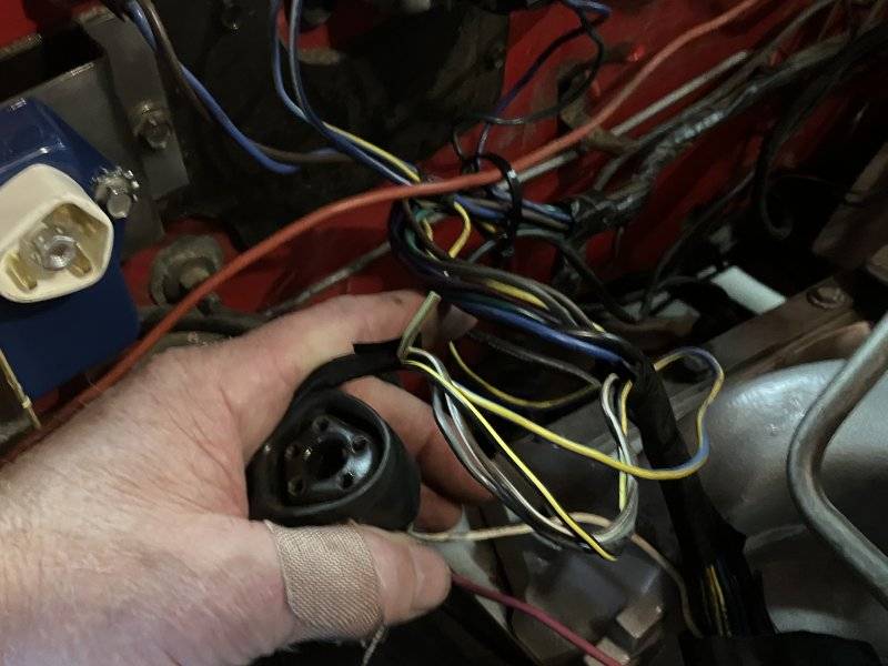

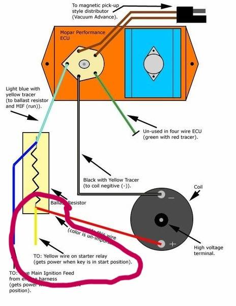

Not as familiar with a 70, but they get power from the yellow start relay to the ballast?
Uhhh, I don't think so but the engine side harness is a reproduction from Evan's wiring. I have it partially unwrapped at the moment.
