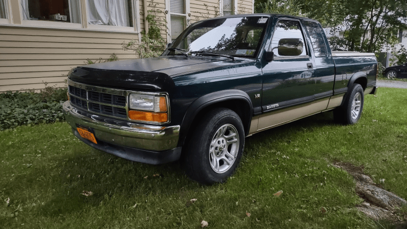

I've heard of people doing this over the years but is it good, bad or indifferent? Thinking about trying it in the beater 95 Dakota....no better test mule than this thing. It developed a lifter tic a couple of days ago that came on a bit slow and got louder the next time I fired it up but so far it's not getting any louder. Still seems to be hitting ok on all 6. Can't remember the last time to change oil but it's purdy dirty.
