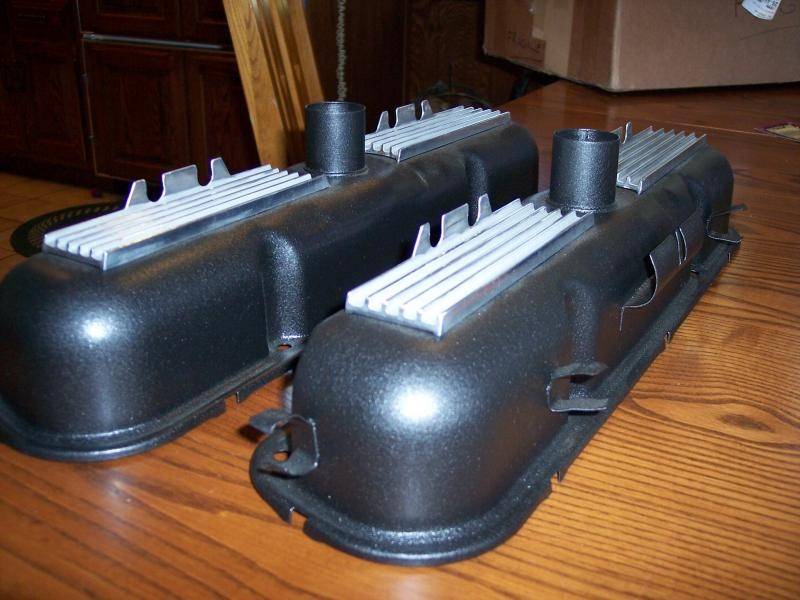

On the HP273 "Commando" valve covers, the factory attached the aluminum plug wire guides with two or three (very sloppy) dabs of RTV black silicone.

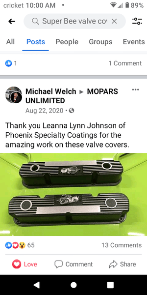

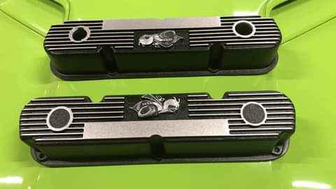

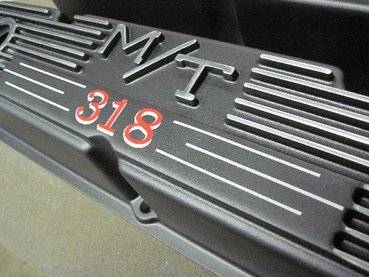

These are probably more along the lines of what you're going for though. Originally a set of Mickey Thompsons, the M/T logos were ground off flush and Super Bee emblems were actually welded on.
I'd personally be more inclined to trust the silicone over two-sided tape. It would suck to put a bunch of work into them and discover you're missing an emblem when you got home from the last road trip.
How Did You Weld Them? Aren’t They Cast Metal?

I didn't do it here. My customer bought them online somewhere.
Whomever did the tig welding achieved well beyond full penetration; I probably have pics of the inside on my computer.
Thinking Of Either Having Them Tig Welded On The Backside Or Sealing The Studs With Rtv After I Press Them In.
