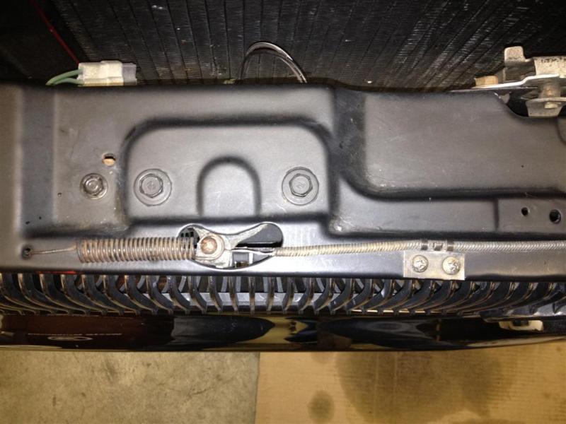

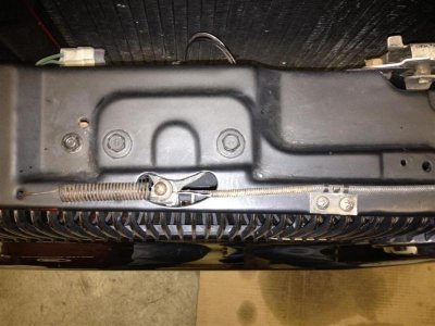

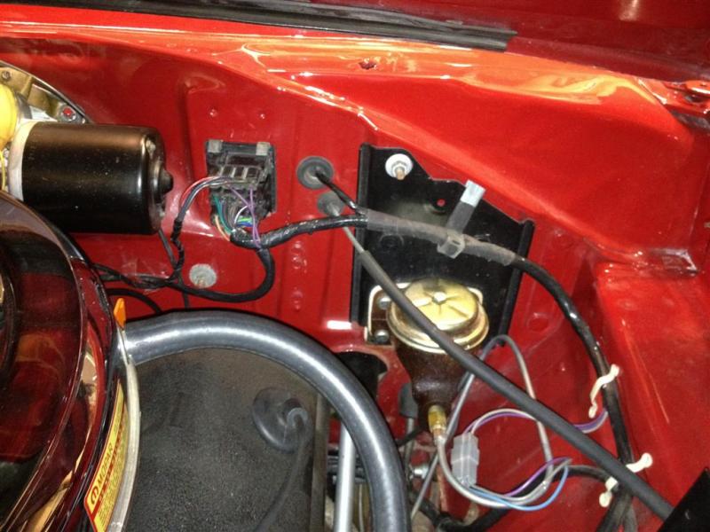

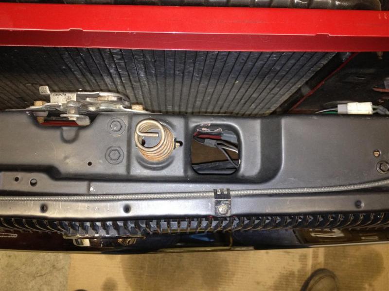

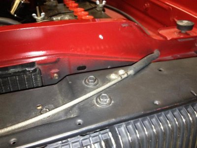

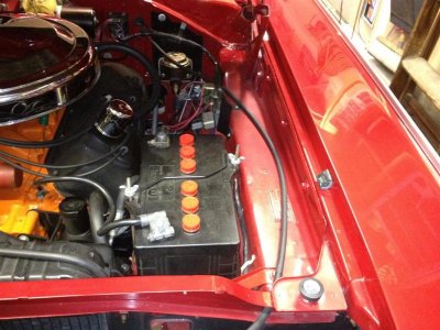

1. My hood release handle and cable were missing when I bought this car. I found a new one and would like some pictures/info on the routing of the cable. The hold down clips are still in place along the top of the front brace where it secures and feeds into the release and it appears to be obvious where it goes through the hole in this radiator core support but there are no clips to retain it to the inner fender. I am assuming it is supposed to run along the inner fender along side of the fender tag.

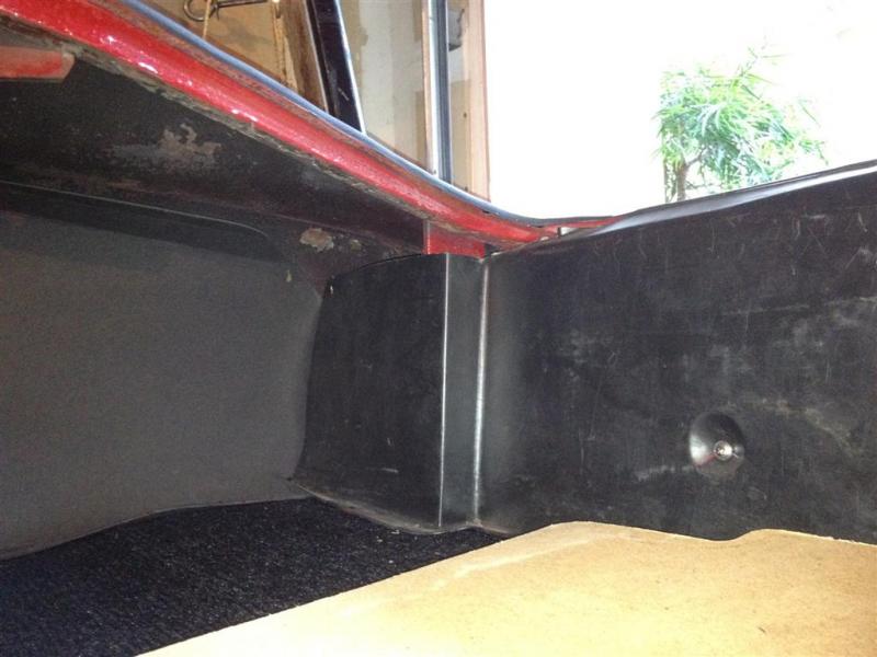

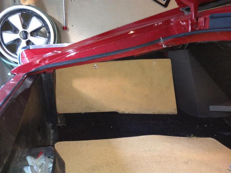

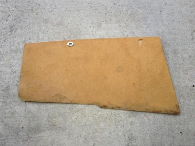

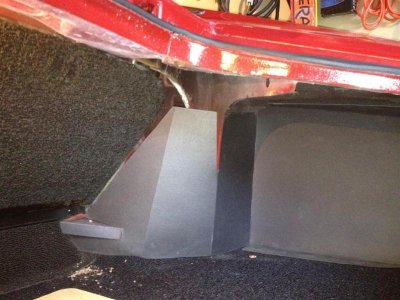

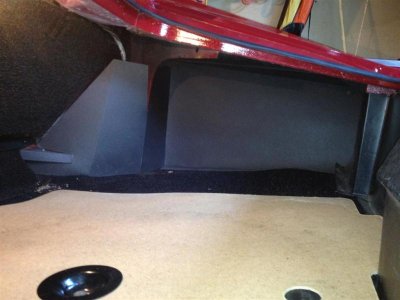

2. I am missing the side covers for the inside of the trunk to cover the jack and the passenger side. There is a turn button there on the jack side and nothing on the passenger side but the covers are gone. Are these some type of formed hardboard that are carpet covered? Are they available repo and if so from whom.

The release cable sits on the inner fender (clips I think) and pretty much hooks up like you say but I'll post detailed pics when I get home.
The filler boards are masonite, again, as you expected. There is a little chrome/stainless twisty button holing it in but will verify in a couple of hours if they are on both sides. I am 99.9999% sure there is a button on the jack side.

The side covers are some type of cardboard material and there is not supposed to be carpet on them. There is also a cover across the back that is molded plastic and it covers the tail lights. It gets brittle and not sure if anyone repos them.

Here are some pics.

More
