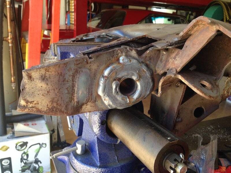

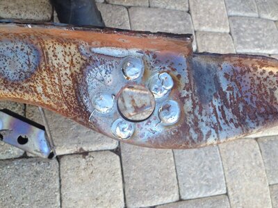

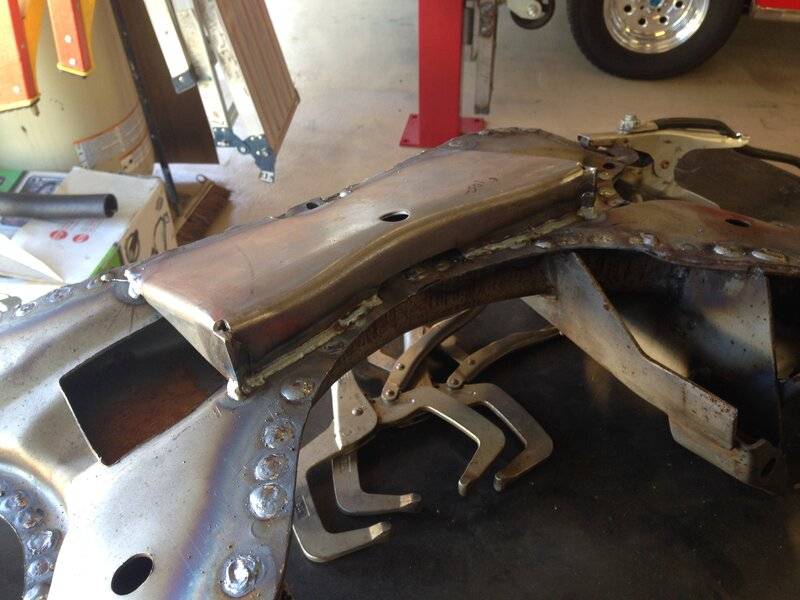

On mine, I added in 120+ welds to it. Reinforcement plates. Skid plate.
617BEF5A-4305-4944-8719-B193E6863CC0_1_201_a.jpeg 0569D135-0F70-4C63-B876-7A3C498C1E89.jpeg EDAC150B-22FD-4AB9-B915-26CF8F5BAB95.jpeg 8C605C5F-FC22-4B0C-9689-11AEA5C47F84.jpeg
Forgot about adding skid plate in my last post

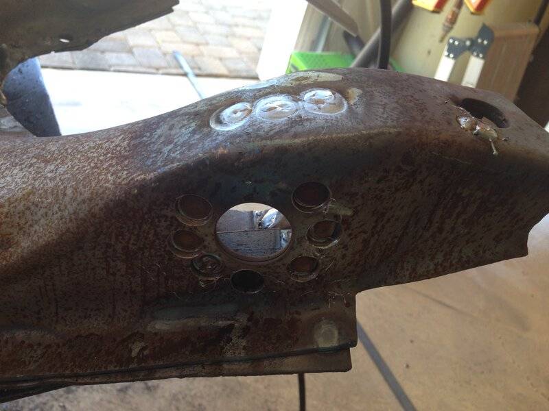

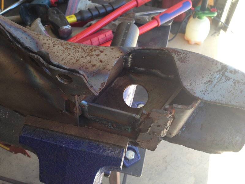

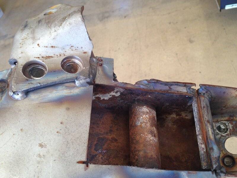

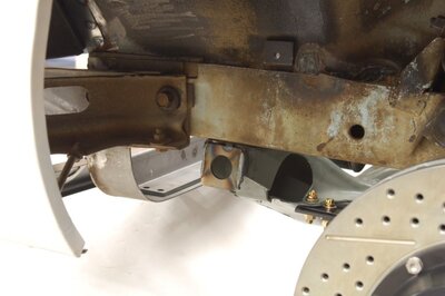

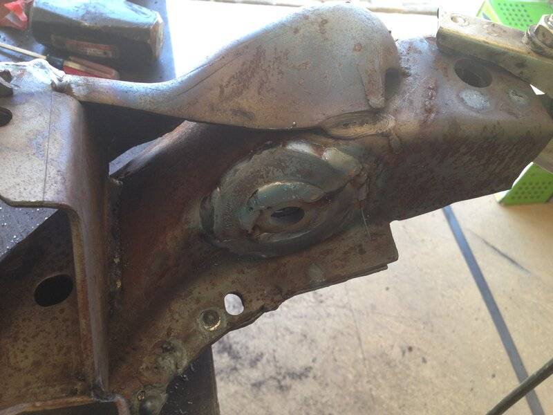

If you are familiar with construction stuff, I look at the welds like they are a specific nail pattern for a shear wall. Or look at older aircraft stuff with components riveted together at certain distances. There were 30? welds on my unit from the factory. I decided to add more by punching holes with my Blair Rota Broach cutters. I also punched into the idler arm mount going two layers with a bigger hole on the outer and smaller on the inner as I was dealing with a total of three layers. I cut access holes at the lower control arm area to get at the sleeves to weld on them from the inside. From there, got some big washers from Fastenal to put on the arm side and nut side to give the area more attachment. The strut rod only has the one layer to mount it. For that I added material in to the backside where it goes through plus the sides and top. Those too got welded in. On the top I put holes through the outer layer to catch that inner piece with some more weld. I still have to do some trimming and adding on the engine side to do when I'm able to get back on the car. If you go this route or similar, get the frame tanked to get the crud off. I had mine done twice but there was still junk between flanges that boiled out when welding. That was when I whipped out the Victor Wrench, aka torch, to burn out the rest. I plan on auto crossing my car so I'm adding reinforcements where I believe they are needed.
3E9AE151-EAAF-46E4-B5BD-A45C813137CF.jpeg 69CD5BDD-5C4C-41F6-85E8-13940BC8068B.jpeg 36210EA2-F5C6-44EE-8B56-856B7591B0A8.jpeg 6CE7B749-1B11-4F88-87E9-F116F3E22705.jpeg
I like the idea of drilling additional holes around the perimeter for more spot welds.

On the nut side, I used the washers that came with my FF shafts. I put the shafts through the sleeves, tacked the washers on, pulled the pins then fully welded k/sleeve/washer together. I also found some structure washers to go around the FF washers that are also welded on.Have not got to the strut rod yet. I got the ones from FF also. Had the $3k t-shirt to go with it. LOL!
Mines cut for pan clearance and drag racing. So the center cut isnt what you'd want for auto cross. It does wheelie in every pass with mo issue.
But rather than adding all those spot welds. Just cut the flange off and weld it along the edge as you cut. Lose weight and its strong.

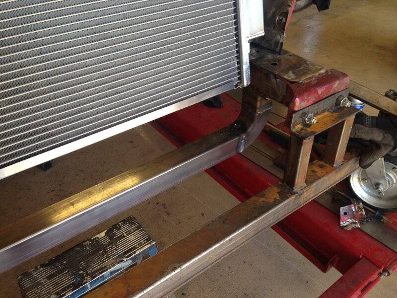

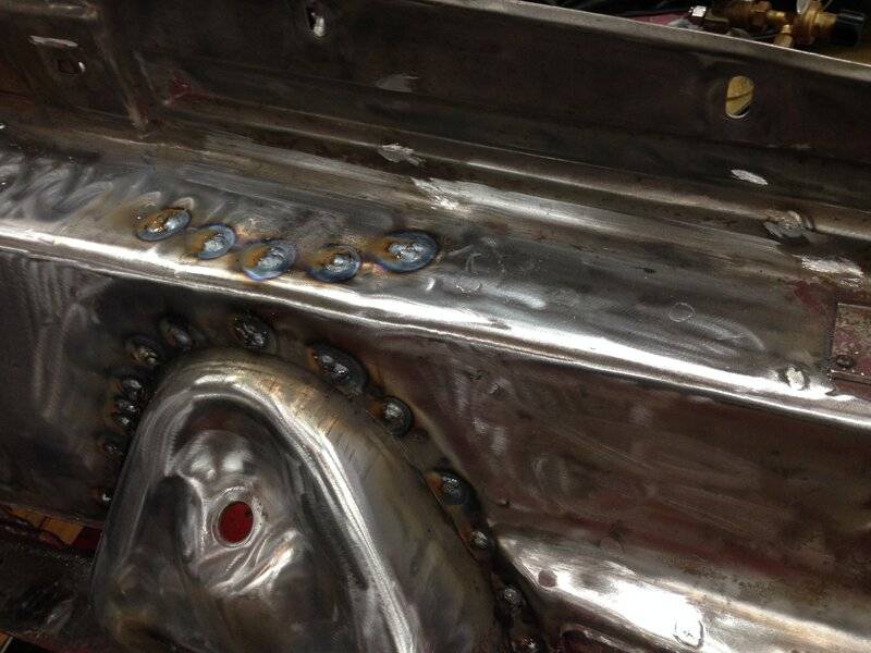

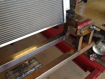

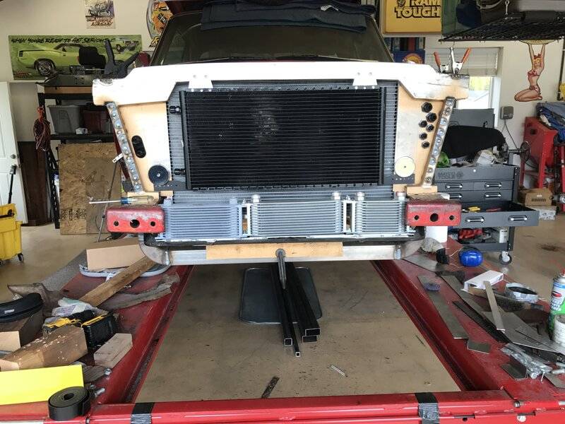

Along with the K work, I added welds to the aprons, shock tower areas, control arm areas plus some others. Will continue this theme as I work my way back on the car. I also made up my own lower tie bar plus the core support. The core was easier than trying to mod a stock one to fit the radiator I'm using plus other coolers.
7F8B7735-5BD4-4024-815C-6D90D0022AEE.jpeg 04A384BD-0A99-46E9-A1CC-6217B4A8AFAF.jpeg 9ADDDE66-D1BF-4CA7-BDC1-9D176185283D.jpeg
