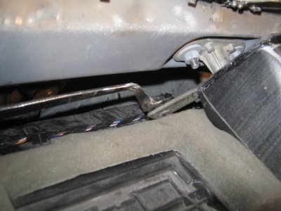

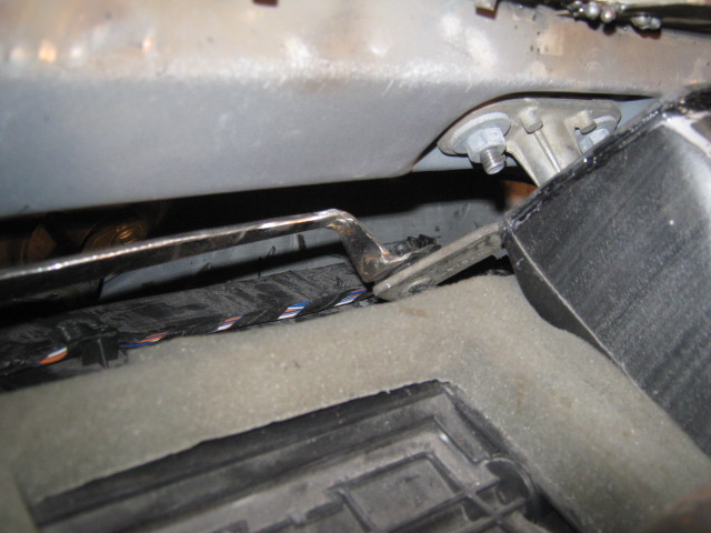

First two pics are the linkage I had to modify to clear the ducts out of the top of the air handler box.

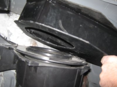

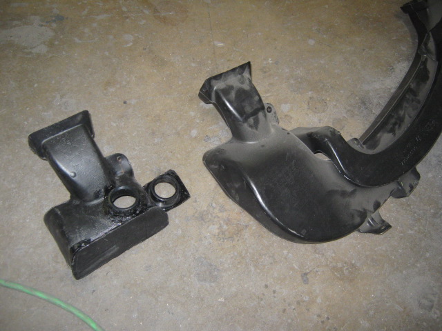

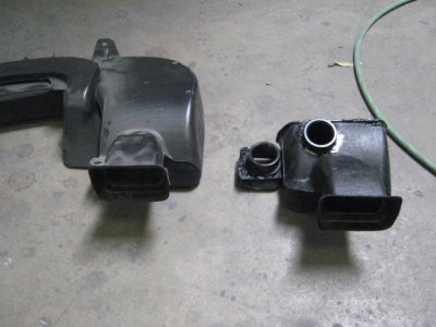

Here is what I did to the ducting from the Charger to work with the space the GTX "allowed" me.
I obviously cut it down and then added some regular plumbing ABS adapters
to accept some 2" ducting from Vintage Air.
The outlet on the side that looks like an attachment was the source for the vent that blows air on the side windows in defrost mode. I abandonded the main defrost vents because I just could not make them work and still have wiper linkage in there. I then used these side vents to channel defrost air to the main windshield. I disconnected the "doors" from the main defrost outlet by unhooking the rod inside the unit so those doors will stay closed and all the defrost air will come through the side vent outlet.
The new vent out of the top will route normal heat/air to the dash vent on the far left and right of the dash. Bottom line is I won't have defrost air to blow on my side windows.........but these cars never had that anyway.

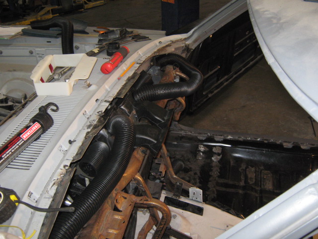

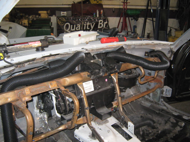

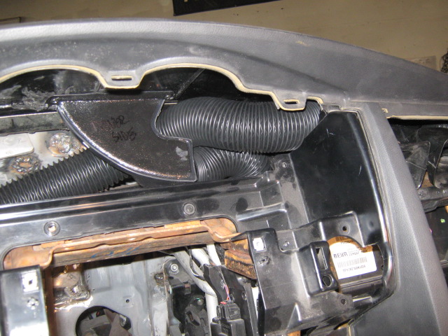

Here are some pics of the ducting loosely routed.

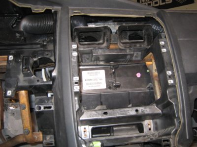

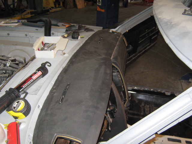

Here is the dash cover in place . You can see the defrost vent assy as well as how I placed the defrost vents through the upper dash.
This was all a major PIA!! I must have put that dash cover in and out 350 times already and there are a bunch more times to go!

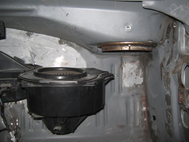

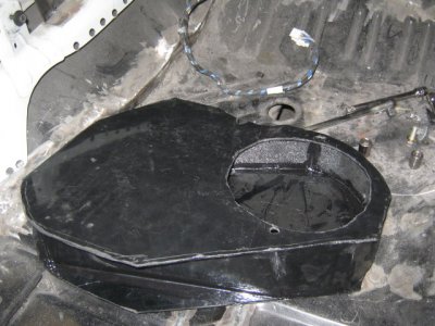

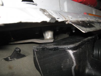

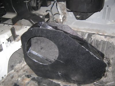

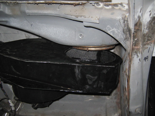

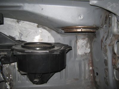

I made this chase/duct for the fresh air intake. One of the bigger challenges on the entire HVAC system actually. I have elected to not have a fresh air vent on the passenger side otherwise this thing would have been much more involved.
I still have some clean up and trimming to do but it is done and fits. It is mostly a compression fit. There will be one screw on the front edge.
