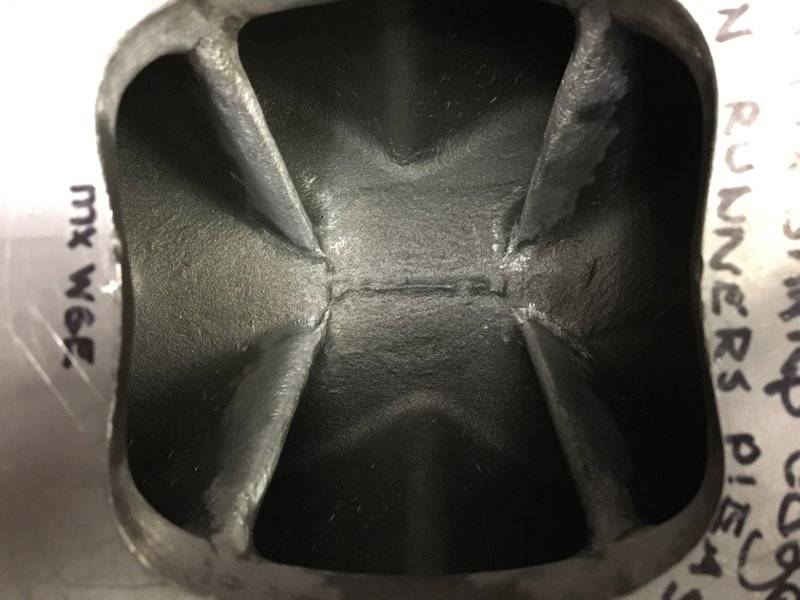

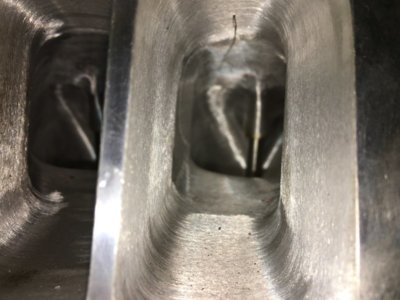

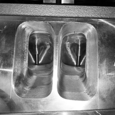

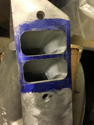

My engine builder went through my Trick Flow 270s. The CNC work was excellent, but he “touched them up a little” and portmatched to my Indy Intake. Was waiting for the pushrods last week, just got my Quick Fuel 850 Q series carb Friday and hope to hit the dyno next week. First 2 picks of intake
52DB6E0C-B053-41BE-9118-572287A6DC63.jpeg 277E6281-4B97-4F42-B940-E030876C0573.jpeg 1D04DAE5-17B1-4856-A506-5B7E9018CF66.jpeg 702182F1-C57E-4CEB-B519-3EA1936C0AD6.jpeg

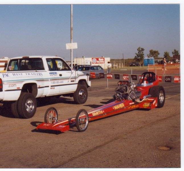

Dave Smith- Sacramento raceway owners car, at the time it was Smith McLennan and Maher.
