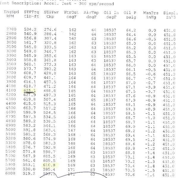

Back in the day was pride. I know what you are saying but the real story is in this forum from 50 year old iron againest the latest new mopar. Building engines with 500 hp 625 lbs of torque and still seeing long life. The style in each one who has or is building one is like that walnut wood put a little more wax on it and see it shine if you know what I'm saying.

I got TF240 from 440 source and let me tell you that I got better than 1st class service from Kim and Brandon. Buy from them. They helped throughout the purchase. I had a set of 440 source and they were great. I then got a set of TF to put onto my 451 and they were better performing heads but at the same time more than double the price when you factored in the pushrods, bolts , header mods needed. 451 pump gas 10.75 comp eddy perf intake and a comp XL285 cam. Just past 600hp and 625TQ very nice street motor. I could imagine if I did a 470 or even a 512. It would be killer on the street and track. Good luck on your purchase.

I really like seeing that. I'm really looking forward to the improvement heads and a roller rocker setup will bring. I've decided not to wait for a stroker before I get my 240s. I'm going to put them on my current motor if it looks like a stroker is going to take longer for me to afford than I have the patience to wait.
