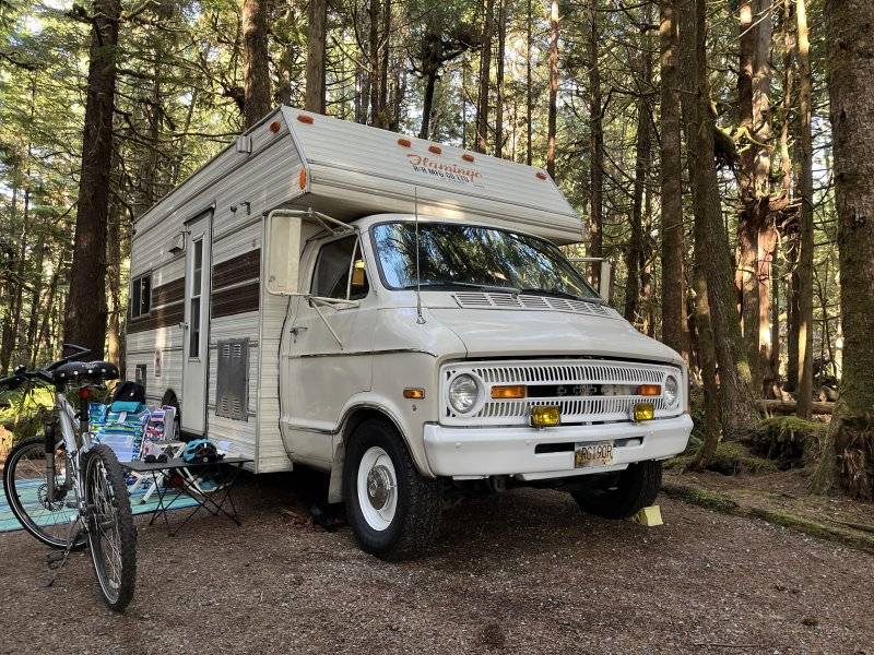

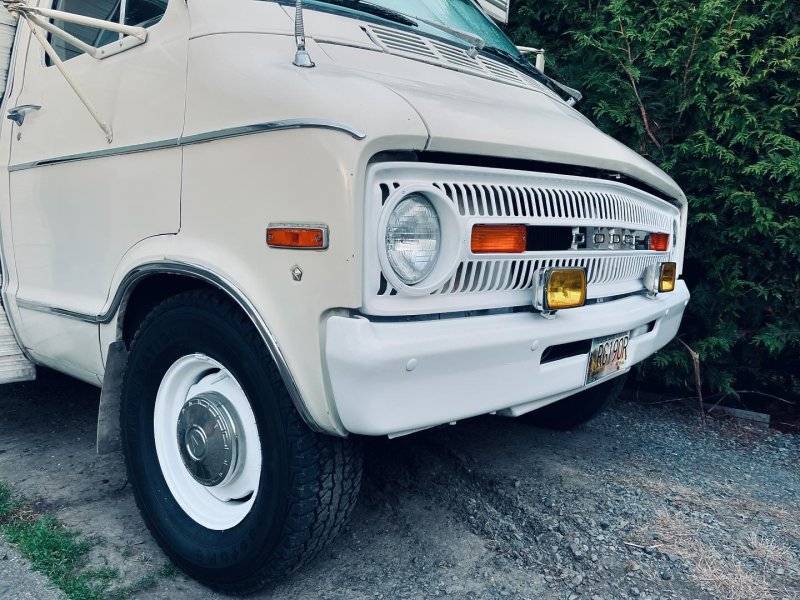

Well… I finished a successful 8 day trip up and down beautiful Vancouver island and camped in Tofino. The 318 performed marvelously up and down some pretty large summits (fully loaded Moho)… staying within the prescribed temp ranges on the gauge and not overheating. I averaged 55mph at around 2400 rpm…
Here are two things I noticed after dialing everything in with your help.
1) on the hottest day 31.5 Celsius (I think that’s 90 degrees south of the border) when we stopped to rest, it was harder to start. It would turn over and maybe after 5 seconds of constant turning, it would fire off. I’d this heat in the carb causing the fuel to boil or evaporate off the line?
2) After each long haul and rest stop, the vehicle was quite fumey in gas. Before the trip, I had set the A/F mixture with a manifold vacuum gauge to 18hg. I’m guessing it’s running a bit rich? No leaks when running anywhere or when not running.
My apologies this isn’t a sexy muscle car, B body none the less
