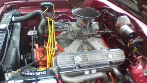

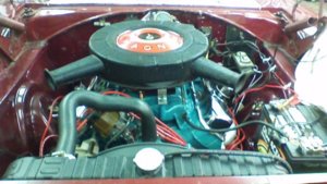

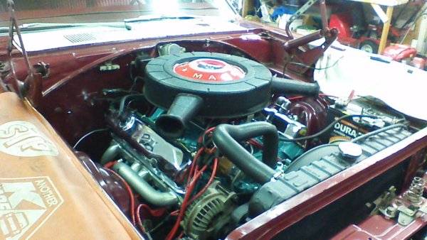

Tex you have a beautiful car. When I first put my 67 R/t together, I put a big crane cam in it, torker intake with 850 Holley, unilite distributor. The car sounded really nasty but was not street friendly. Then I went a different route. Installed comp xe 268 cam, edelbrock ChB intake,750 Holley crab and pertronix 3 installed in the stock distributor.Very happy with the way car runs now.I pump the gas twice fires right up and drives perfect. Painted everything factory color can't tell from stock.
