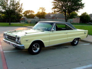

Trying to sell my car has been a resounding flop so I'm probably going to keep it. I bought this car because of memories of another 67 GTX I owned back in the 70s. The look and feel of the car is spot on but I have not been happy with the engine mods and overall performance so if I keep it I think I want to take it back to factory specs. The first change will be to remove the "Hemi Mufflers" which I think are just empty shells and replace with actual mufflers similar to 440 specs. Can't stand the noise and drone! After that I want to:
  • Replace the lumpy cam with the stock 268/284 440 Magnum cam
  • Replace the MP high rise intake with the OEM iron manifold.
  • Replace the Edelbrock carb with an OEM AFB or AVS.
Back in the 70s I remember changing the cam, carb, trying a Tarantula manifold, even adding a six pack setup and not being happy with any of it, when I put it back to stock it ran the best. Has anyone else gone this route and done a retrofit?

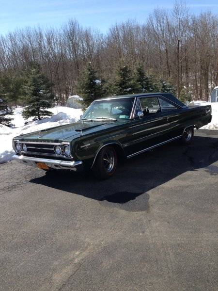

I am slowly bolting on more **** so I don't want to be left behind....
BUT I hope that is as far as I hope to go....old pic 4/ 8/ 13, just for S/G
