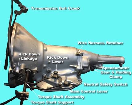

Its the Neutral Safety switch on the Transmission. There is a 3 wire connector plugged onto it. Make sure the connector is on it and plugged in. Driver side of the transmission its the only wires going to it so its not confusing.

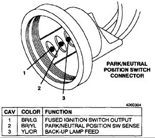

Here is the connector and its wiring.
Here is the location of the NSS

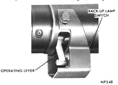

He is asking about the back up light switch. Which in 68 is either on the column or on the floor shift.
Umm number 3 on the wiring schematic is the reverse light feed. And as far as I have ever seen the NSS is what turns on your reverse lights. I have not seen a switch in the column or the console. Pretty sure the NSS does the switching. Possibly in 68 but I'm not aware of that. So I may be wrong.

The switch is in group 19 steering columns.
Thanks all. But I know what it looks like just not understanding where it is exactly it is on the column and if I need to remove it or dash to get to it. Really don’t want to screw it up.
More than likely the plastic actuator bat is gone.

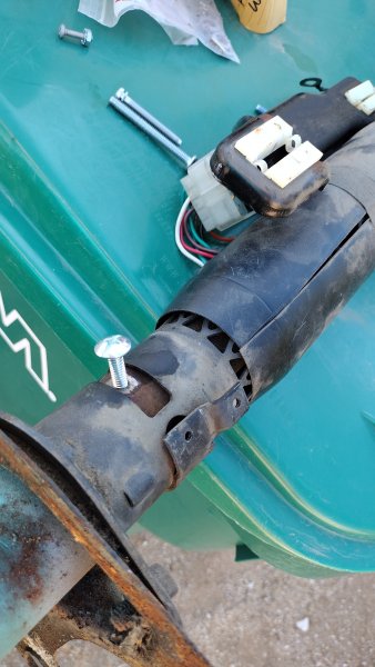

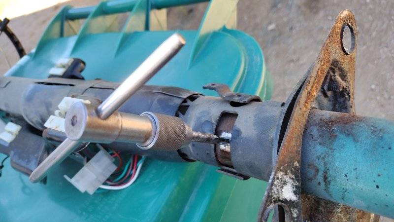

Various fixes from taping the hole for a nylon screw to upgrading the transmission rooster comb for a 1969 or newer switch.
I'll see if I have any pictures of my fix.
Ok I found where it goes so it looks like the operating lever is broken so I will need to figure that out.

I used a 1/4 20 tap that had the flat bottom. Got about three threads tapped. Ended up using a nylon screw about 1.25 inches long. Working great.
Ok. So I will need to take column out of car! I’ll try it! Thanks
Not necessarily. If you can contort into position with the gear selector in 1 you might be able to tap it.
