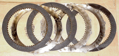

Ok.. pulled it out and apart, took a ton of pictures and there is no point in posting them.. everything is 100% fine, not a single mark anywhere.. soo that leaves the converter, what my theory is at the moment is i messed up the tf-2 kit somehow..
My question is, does the valve body control fluid pressure to the converter? (not thought bout it before, always figured it was just a constant on old trans)
If so.. could i have messed up the kit to make it either over pressure or under pressure the converter? Didn't make a single bad sound in neutral/reverse/1st but soon as i hit the button for second the sound came in..
Only things i found wrong is the 4 clutch pack is .053 not .060 and the 5 pack is .090 not .075.. i thought i had them closer than that..
090" is O.K. for front clutch pack (even up to .100"), but rear clutch pack should be down closer to .025"-.030". Twice the clearance on the rear clutch pack may be giving you your noise? I once rebuilt a 727 for a customer, and he called to say it was making a lot of noise and would hardly drive out of his garage. I grabbed a spare valve body, and went down and changed it out. We put it all back together, with no improvement. There was kind of a swishing/whistling noise coming from the front end area of the transmission, and he had to rev the engine up to get the car to move at all. I told the customer he had a bad converter, because it sounded like the unwanted noises were coming from it. He responded that he had just bought this new piece from a local speed shop. I told him to take it back, and see if he could get a replacement. He called back a couple of weeks later to say that the seller replaced his converter with another one. He had installed it, and his car worked fine, with no odd noises. So, it can happen; just because it is new, doesn't always mean it is good.
