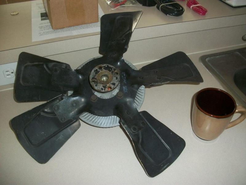

Is it true that if there is any play in the water pump pulley that the pump is bad? I have an aluminum water pump on a 440 that has the main housing and the separate pump in the middle. The other day as I was installing a new fan I noticed that I can wobble the fan/pulley side to side a little bit even though it was tightened down to the pump. There is no leaking and last time the car was running there was no sound coming from the water pump.
that shouldnt be there ....but.....its not leaking. i would have one at the ready coz it might be soon youll need one!
If I have to replace it, I have to remove the shroud, box, radiator, and fan. If it is bad, I should just replace it now while all those parts are already off. Here is what I think I did wrong. The other fan hit the shroud under full throttle. By the time I got that fixed the ends of some of the blades were ground down some and I later discovered a couple blades that had changed position. I bent those back. It is not like I am totally derelict, look, the fan isn't as bad as I am making it sound. So the clearance problem sent shock waves through the bearings, and the fan blades being slightly deformed unbalanced the fan. I will not be surprised if the pump is bad. If this pump is bad that will be really bad on my part because this pump is a fairy new piece. It looks like later I will need you guys to help me pick out a pump, i.e. standard or high flow.

if it moves,replace it.it means the bearing is starting to fail.the weep hole leak only detects seal failure.fix it now before you get catastrofic failure.i have seen a flex fan stick through a hood before.not pretty!
