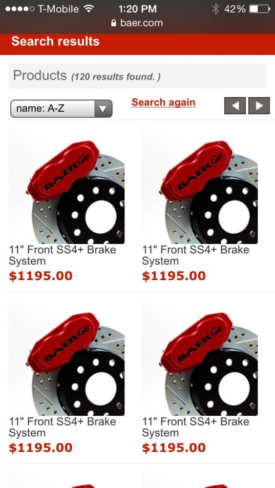

Currently have Wilwood forged dynalites. Rear drums. 15/16" cast iron Raybestos blue label box MC with 8" dual diaphragm booster. Pedal feel is good. Clamping force and stopping power at high speed is not. Several shops have recommended Baer as a much better alternative. Less caliper flex and more clamping force. They only offer this one caliper that fits 15" wheels. I do have caliper adapters and 11.75" rotors already with the Wilwood setup.
