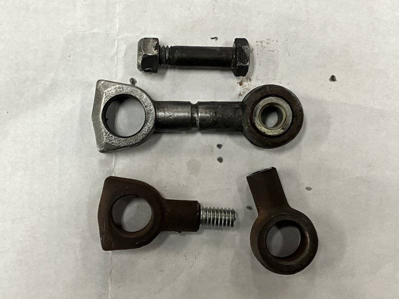

I remember pulling a booster out of a C body, it looked exactly like the one in my GTX........I soon discovered that rod ^^^^ was a different length, most likely too long; this was likely 1986........ anyway, I cut and welded it to the proper length and it worked. I still have that booster on my shelf
But does it work???? Turned out pretty good for a quick fix... Bridgeport is your friend..

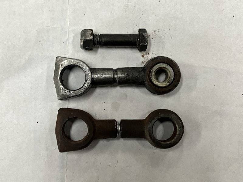

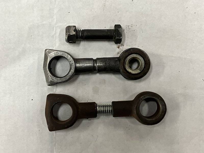

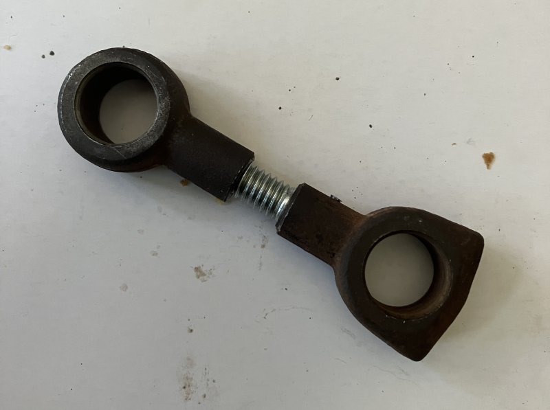

The helpful FBBO member had a better idea. (I'm keeping his name a secret until he says it is okay to tell.)
Yes! An adjustable pushrod. This was a stock unit modified to allow extension.
I could put a nut on the threaded section so the two halves would still make contact and make a solid connection. My rough guess is that 1/4" of adjusting out may be more than enough to bring the pedal up to where I want it.
Looks like a great solution to me.....Once you get it adjusted to bring your pedal up to the clutch level, You could weld it and file a groove for the anti rattle spring if you put one back in.
I don't see a need to weld it.. Once it's bolted at both ends it can't unscrew... It's only .060 smaller in diameter with the bolt than it was with just the reduced area for the spring, you can still pop a spring into the area where the bolt lives....

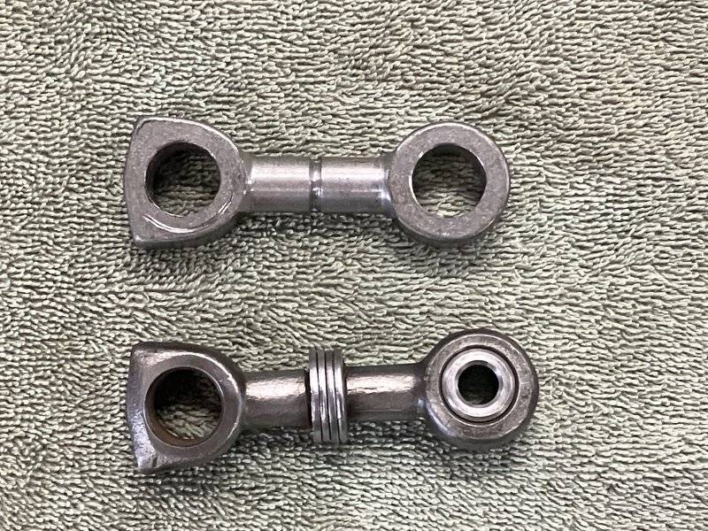

The fittings are seasoned ones...originals from the mid 70s. When I get around to replacing the brake lines, I'll look for new fittings. In the meantime, I did change the brake pedal pushrod.....Stock type on top, modified one below:
I used washers as spacers and coated the threads with Locktite, then swapped it in.
The pedals are almost even now, close enough for me.
I could adjust the clutch pedal if I wanted but I might leave it as is.
The pushrod clears everything.

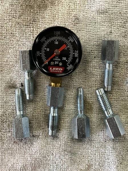

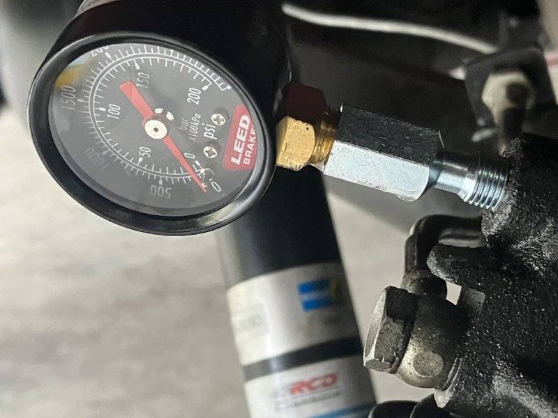

I bought a brake caliper gauge....
View attachment 1413869View attachment 1413870
I only measured the rear and it registered 1200 psi.
I'm open to any and all suggestions except swapping drums back on the rear. There is something wrong with the system and I just am not seeing it.
Can you skid on dry pavement?
The hydroboost is what you need. You should be able to achieve 1500 psi on the fronts. I don't know what unit you used, but all my experience is with Hydratech and my results have been outrageous. Secondly, I don't know what type of linings you have but anything generic is pure junk. We have carbon kevlar pads and shoes for everything. I highly doubt you'll be able to make that system work the way you want without a HB.
