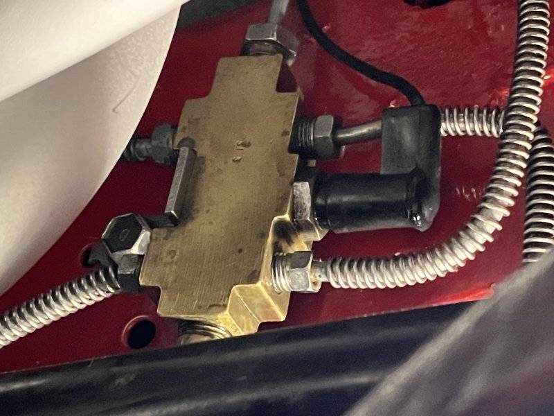

Of all the combinations that I have tried, there are a few things that have not changed. I wonder if those remaining things are where the problems are.
It crossed my mind that maybe this valve is blocking or reducing pressure or volume to the brakes but when I tested the right rear caliper, it showed 1200 psi. Maybe I should take the car out to a parking lot and see if the parking brake can lock the tires. That might tell me something.

My understanding is that the drum-drum blocks have NO proportioning. Those 4 wheel drum systems rely on wheel cylinder sizing to determine proportioning.

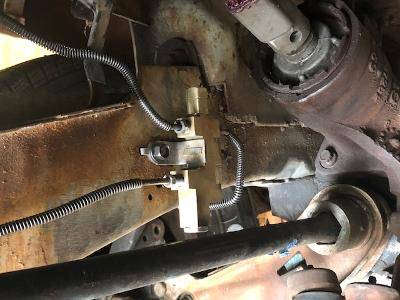

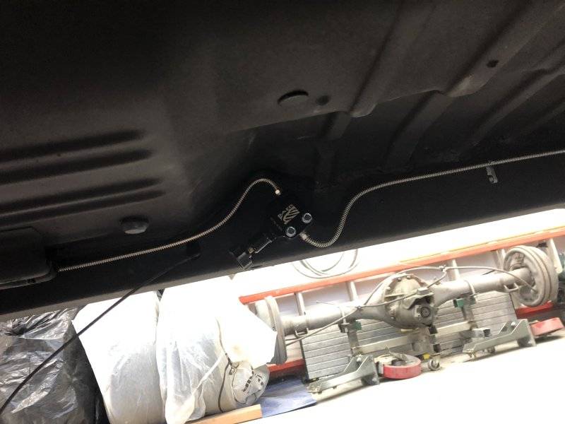

The 73-76 A bodies with front disc-rear drum used a block with proportioning built into it. Some call it the "Texas" valve due to it's shape.
This unit is somewhat complex. It is a fixed design that limits pressure to the rear to try to prevent lockup. The drums take less pressure to work due to their "self energizing" feature.
I had one of these in the car with 4 wheel discs.
I changed to the drum-drum distribution block and it did improve braking a slight amount.
I've tried manual master cylinders of different sizes, I've tried the power booster with and without a vacuum pump. I changed the front brakes to 13" with performance pads. I changed the rear brake pads. Everything has been bedded in.
What has not changed is the rear calipers and the brake lines themselves. The hard lines are in good condition. The flex lines are new.
I have considered running the lines without the distribution block to see if that helps.

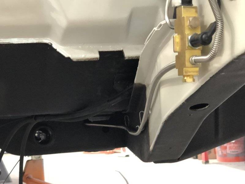

I have been kind of following along on this thread and I may be just repeating something already posted. You said you’re currently using a drums only distribution block. Have you tried an adjustable proportioning valve for the rear discs ? Please disregard this if you have done that already.
Our 64 Sport Fury has 4 wheel power disc with only the adjustable prop valve on the rear brakes and will stop on a dime without problems or lock up the front and then rears if you want to. Adjustments were done on a damp parking lot.
