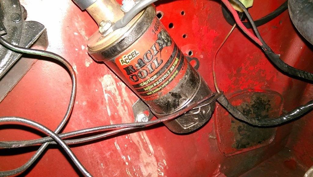

Got home from work & took some pic's but now need to see if I can find any info on my coil. Accel Racing Coil #140305. Also noticed I have 3 wires connected to 1 side.
I'm not sure why there are thee wires.
The second wire on the negative side is the tach wire.
http://www.jegs.com/InstallationInstructions/100/110/110-2030.pdf
This article mentions the use of your coil. Near the top where it says exceptions 1)... it states that with that ECU and coil combo a ballast resistor is not needed.
You may be able to tie both sides of the ballast resistor together and clean up your firewall.

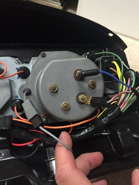

Thanks! I know one of the wires is for the electronic choke. As far as the tach that's great info as it's not working (has power) but I discovered a purple wire under the dash that's connected to it but is not plugged in. Its an Auto Meter Sport-Comp (not a Comp II).
Any ideas where it plugs in?
View attachment 505050 I'm not sure why there are thee wires.
The electric choke should not be connected to the coil. It should be connected to the 12v side of the ballast resistor or voltage regulator. I'm not familiar with that type of tach. Here is a pic of the back side of a tic toc tach
View attachment 505019 View attachment 505020

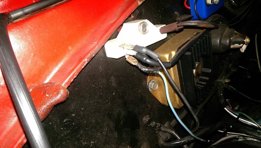

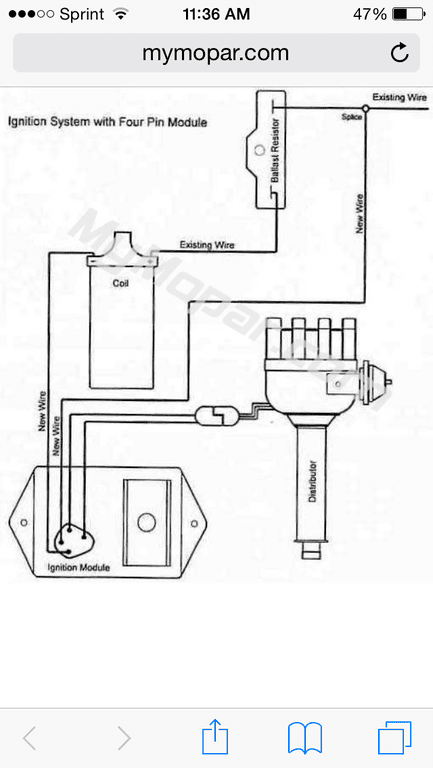

Looks like you have the ole mopar electronic ignition kit.....That is something I personally would change....Of course as a future product to something much more reliable...
Thanks Justin! I searched for a few hrs last night & only found a reference from Accel's 1973 & 2011 catalog but never found the exact same one. What kind of issues does this have and what would you recommend, not looking for top of the line.
Control unit failures, especially the orange box. Which is probably why yours has the gold box.
