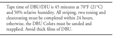

Note to self- not sure about other paint systems but using PPG for many years I have cleared the base from the same day to a week.

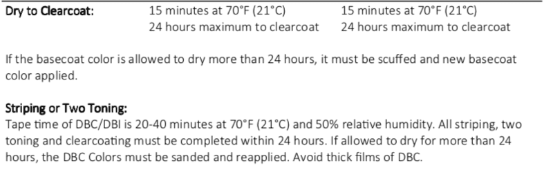

From the PPG DBU P sheet...

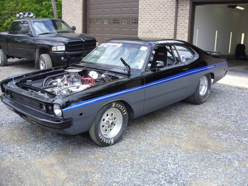

They range from 20 years to 4 years the 67 gtx I have for sale on here was painted in 2015 the black 62 polara I had for sale on hear was painted in 2014 Just a few
SDC11964.JPG SDC12142.JPG SDC10156.JPG 008.JPG SDC10436.JPG SDC10651.JPG MAY 9th  67 GTX AUTO 001.JPG ta & cuda grill parts 029.JPG
