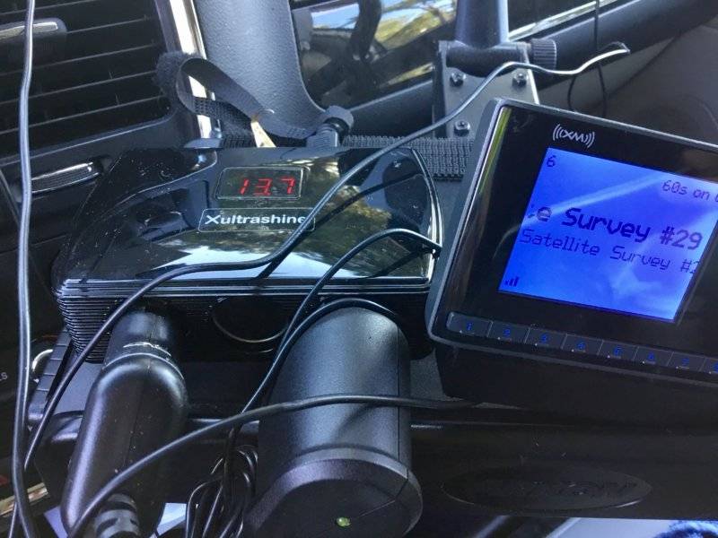

Not a fix, but I have found this multi socket for all my electronics to be helpful for output. Also not a fix, but I use the battery cut out marine grade from West Marine to ensure no parasitic draw overnight.
