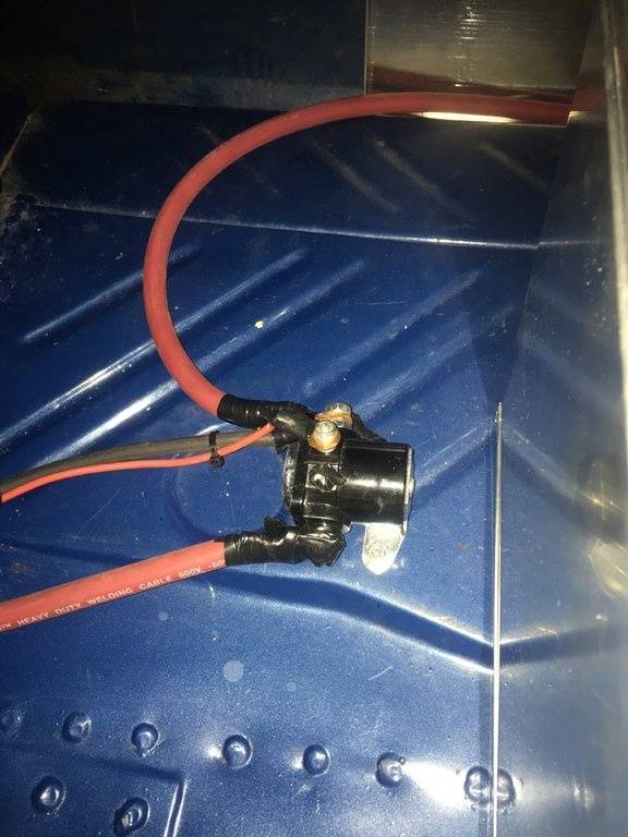

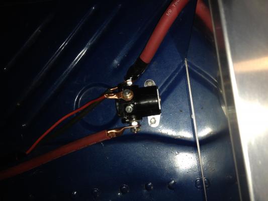

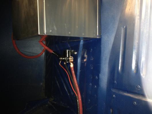

Just relocated my battery to the trunk, and I have just one question (for now) - has anyone found a readily available cover for the ford solenoid? I use the trunk a lot and want to do something to protect it - other than wrap the connections in electrical tape.
Thanks! Oh and I'll post a few pix in a few.
Why not mount the relay too the outside of the box between the fender. Out of sight, out of mind....

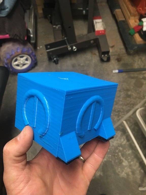

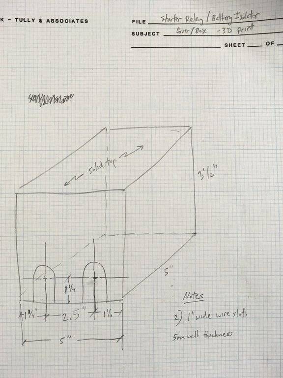

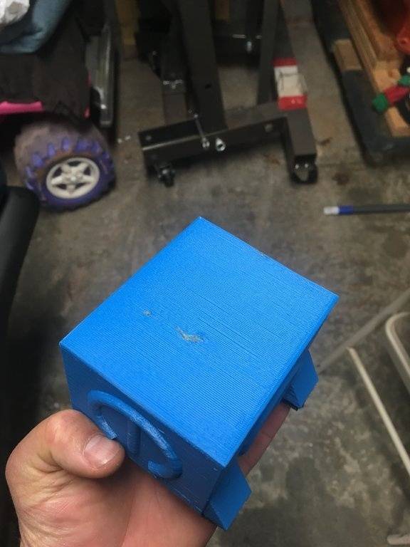

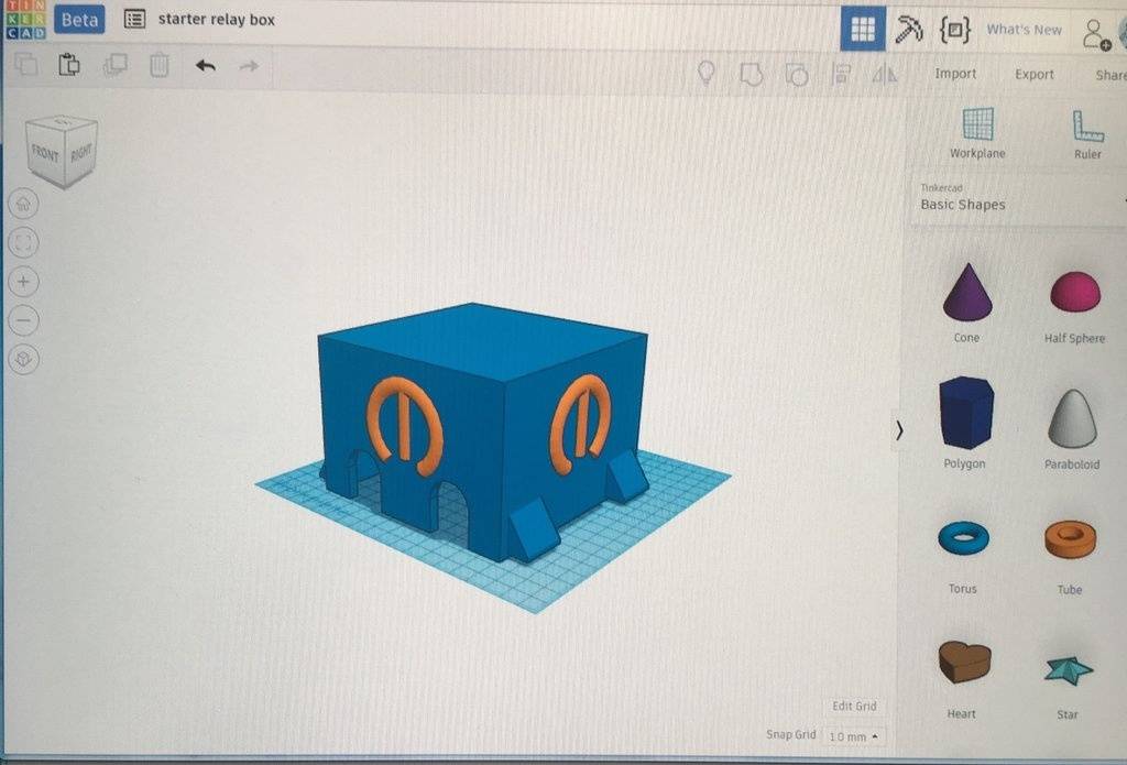

Time to awaken this ol thread. After a year of off and on looking, finally decided to make my own... gonna 3D print it.

It's a good idea but in this case, walls of the box are removable, I don't want to have to try to wrestle the 00 wire when I have to slip it over the battery from time to time. Otherwise, that's exactly what I'd have done.

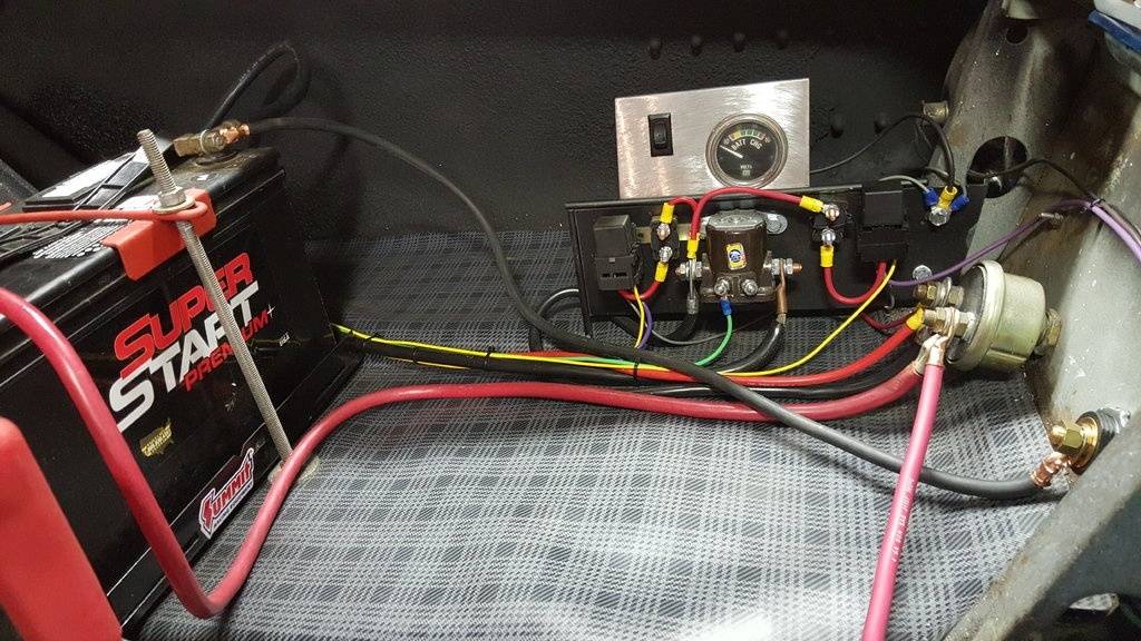

Relay on left is fuel pump. Relay on right is trans cooler fan. Solenoid for starter center. I added gauge to use in pit with charger. Switch controls gauge. This setup has worked very well.

Those 3D printers are pretty amazing, we have them also.
View attachment 427662 Should be done in 10 hours! Of course my shop is closed for the holiday, so I'll have to wait for Tuesday.

My thought is to mount the solenoid behind the battery box, instead of in front of it. Turn the box around and run the cables through the trunk floor just outside the box with rubber grommets. That would look clean as a whistle and protect the solonoid from accidental bumps.

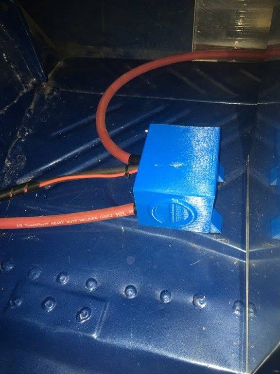

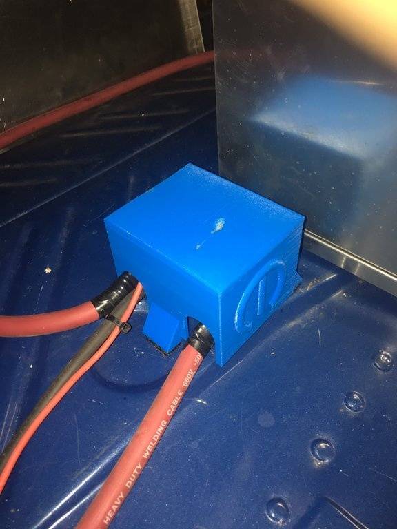

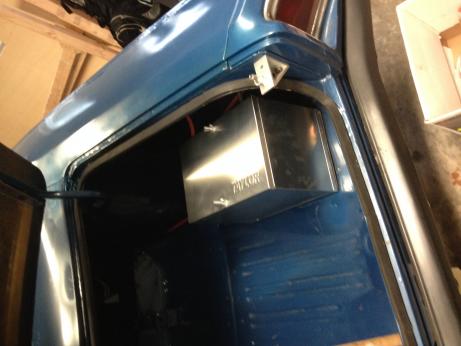

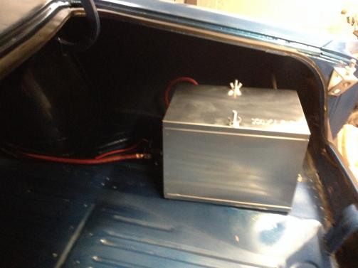

Here it is. The top got a little fubar'd but for the most part it fits like a dream and does the job. Probably just toss a mopar sticker on it and call it a day.
Nice box! I got this self-fuse tape the other day at home depot. It's great for electrical wrapping.
