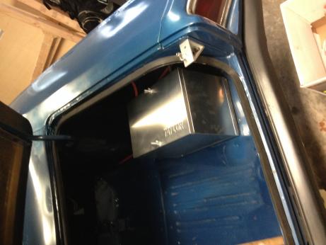

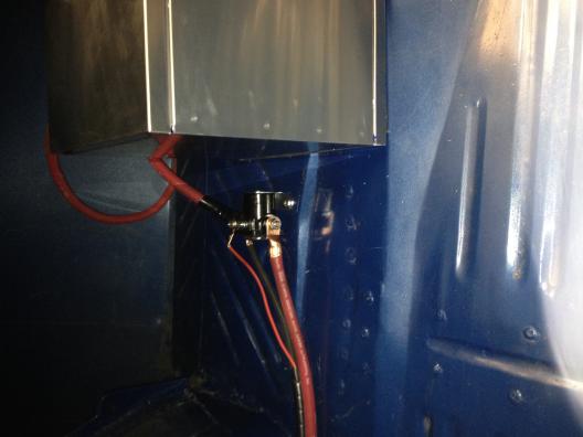

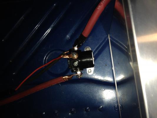

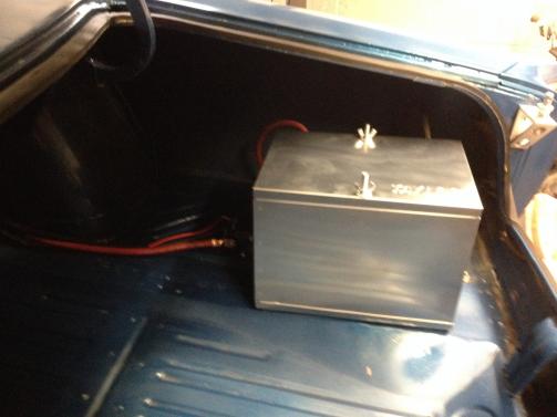

Just relocated my battery to the trunk, and I have just one question (for now) - has anyone found a readily available cover for the ford solenoid? I use the trunk a lot and want to do something to protect it - other than wrap the connections in electrical tape.
Thanks! Oh and I'll post a few pix in a few.
Dang that installation looks sharp! I've never seen a cover for a Ford starter relay on any car ever...including my old '68 with a bad ignition switch that I used to start from under the hood with a butter knife (haha). You make a really good point though.... that's a lot of un-covered hot wire there. Maybe try some big heat shrink wrap on the cables and a big glob of silicone on the smaller side-terminal wires? Or maybe you could find some type of small plastic box that the relay fits inside and cut/drill some holes to let the wires feed through?
Nice looking relo. I just did the same in my Coronet, still have to tie in the front end wiring. And I need to find a solution to the open solenoid too. Probably wind up fabbing a plastic box like PurpleBeeper said.
In your pics I see the red start wire, is there a charging wire coming off of the Batt + lug that I'm not seeing?

Yeah it's a terrible picture, there is a black #6 wire attached to the battery lug.
Curious to why you need a solenoid in the trunk?
I prefer to have one because this way the big #1/0 starter cable is only hot while cranking. It's important because whereas you can easily put a fusible link on the alt wire in case of a short, the starter draws so much current that a fuse / fusible link would have to be so big it would be useless in case of short.

Consider using terminal boots over the bare connectors on the solenoid.
http://www.summitracing.com/int/parts/aaf-all76152
Those look good - I just electrical taped the terminals last night, but I might just try those... thanks. Any ideas on how to protect the entire relay from, say, a flying stroller? (lol)

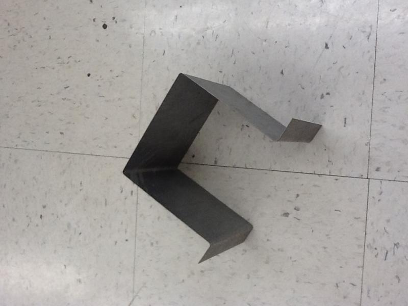

Just for fun, I decided to make a simple enclosure up from some scrap galvanized at my shop at school. Not sure I'm going to go with this, but tonight I'll test fit and see how I like it. 5" x 5" x 5", probably a little big, but it should protect from an impact from a shifting set of golf clubs or cooler. Truth be told, I tend to strap that stuff down anyway, but just in case...
I wouldn't use metal for the shield. Maybe something not conductive. Plexiglass? Maybe use one of the reverse light holes in the bumper for switch?
Good point, in trying to protect it, I may be creating a worse situation. Food for thought.
How about making something out of fiberglass? You could use some plasticine for getting the shape you want. A little more work but might be worth it...
BINGO! Excellent idea, that's exactly what I'll do. Stay tuned.................................
