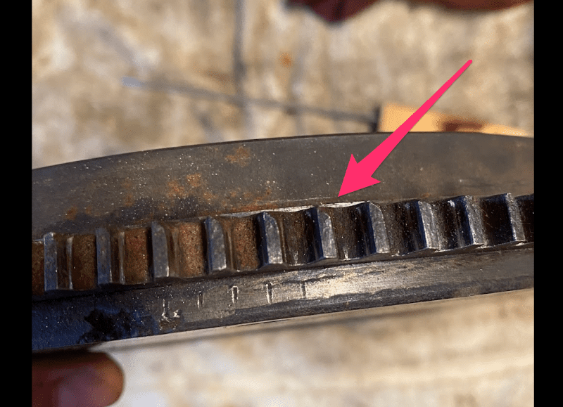

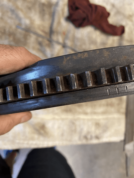

Hoping you all can give me your opinion on this. Do these flywheel teeth look bad enough to make it so that the starter won't engage? The issue I am having is that the starter only engages and turns the engine over about half the time. It doesn't grind or anything, it just seems to click like the bendix gear is trying to pop out just is just banging into the flywheel. These are about the worse spots on the flywheel I could find, which don't look terrible to me, but I'm not an expert. Maybe a 1/4 of the teeth have wear like this.

Those teeth look okay. I usually don't recommend replacement until half of the tooth is gone. If you desire to replace the ring gear, replace it first, then resurface the flywheel.

I think you can heat and remove that ring gear and flip it over. I have replaced a few gears on torque converters.

The ring gear is more than fine, it is in great shape.

Thanks all, you all confirmed my suspicions that the flywheel is fine.
