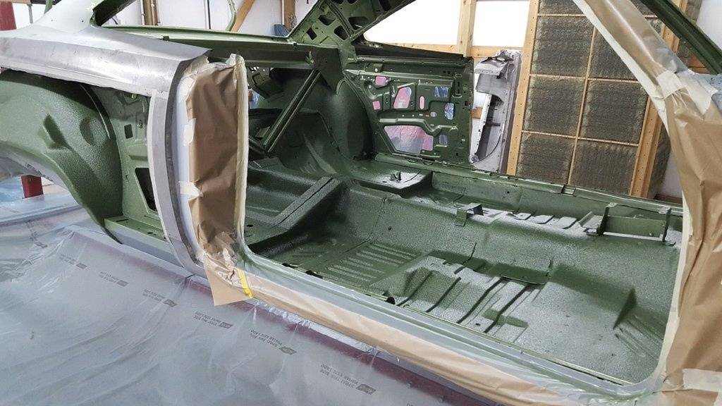

I used tintable bed liner on the inside and black bed liner on the bottom. Hoping for sound deadening and protection.

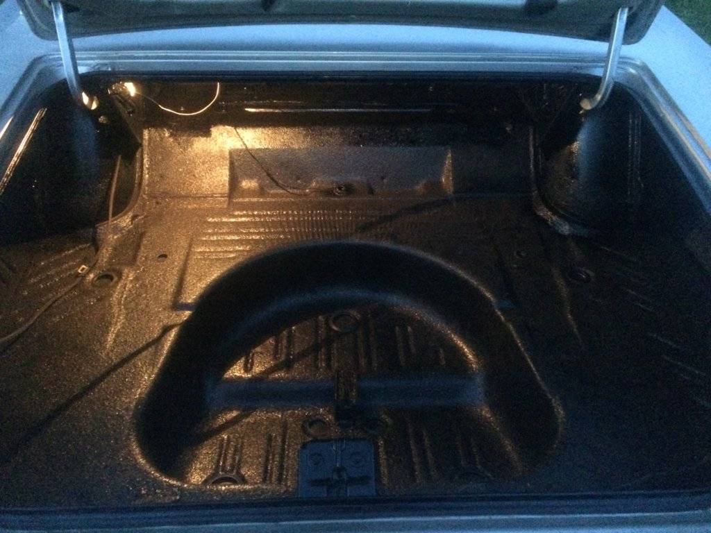

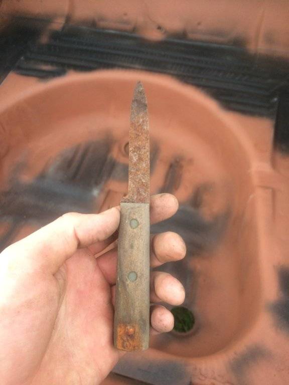

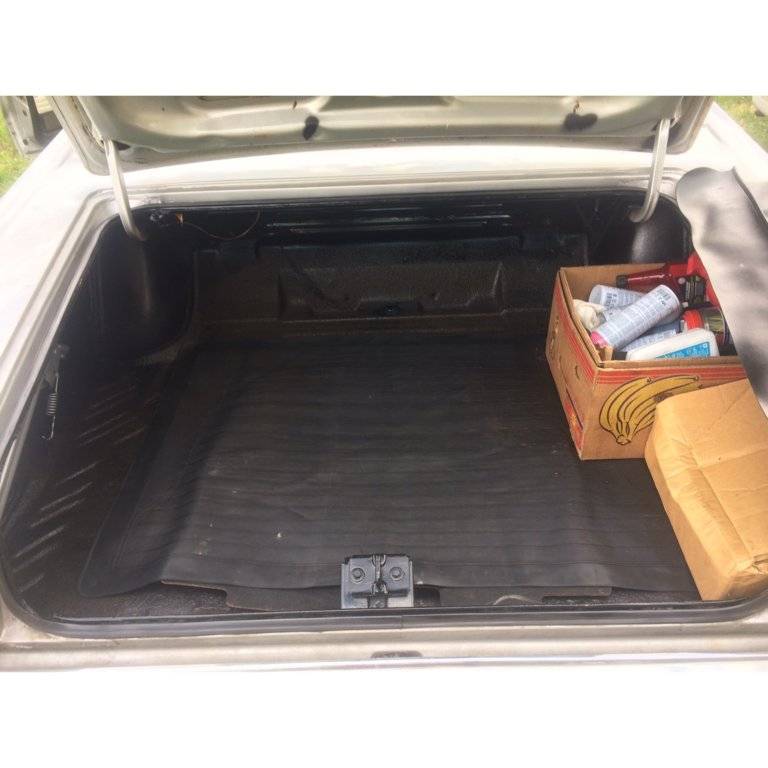

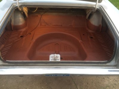

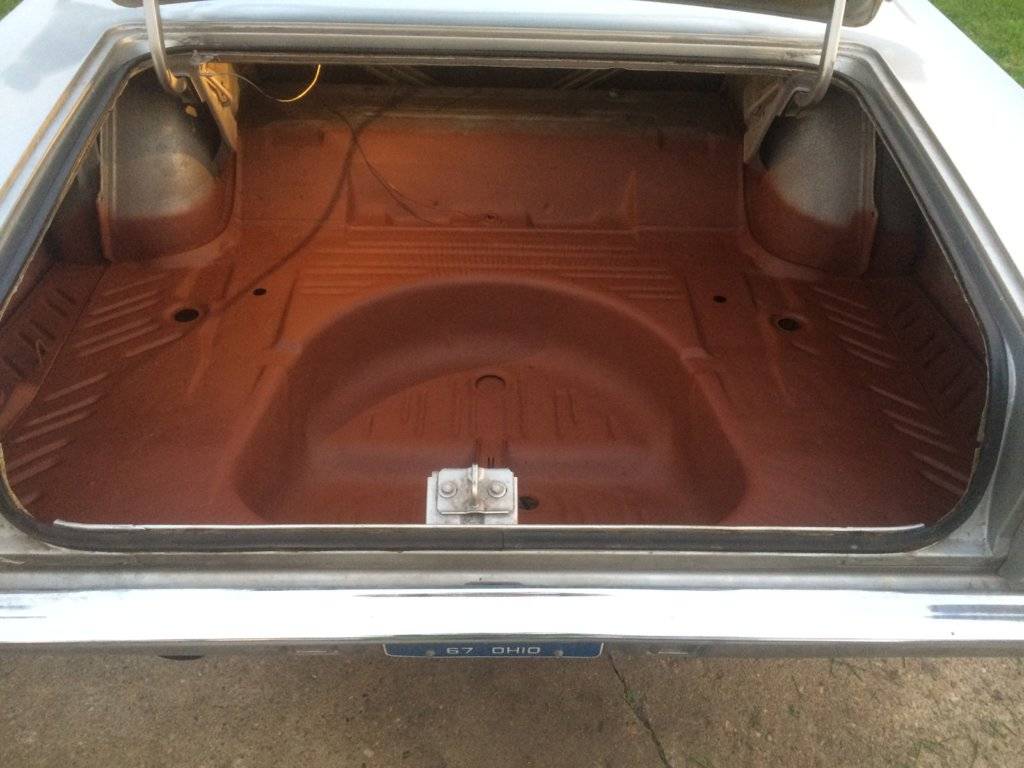

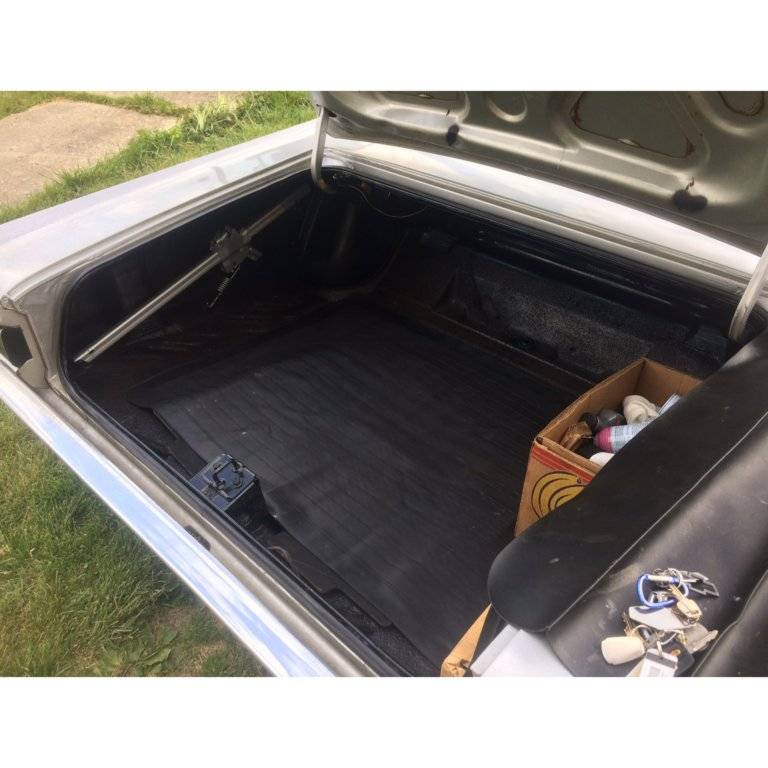

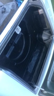

I did the trunk in my 67 Coronet with Herculiner. Previous owner painted over rust so I had to climb in and wire brush and fill in pinholes for 3 days haha. I then hit it all with rust reformer in the iffy spots, rusty metal primer in the ok spots and once everything cured I primed over it all snd scuffed it, then applied the Herculiner. I'm not afraid my quarters will rot or my trunk, looks pretty good and nothing slides around anymore and won't marr anything. I'm going to do my floors inside the same way. I also found a knife in the passenger quarter haha, you can see the reformer in that pic. Excuse my less than stellar photography. Mine is textured though, do if you want a different look you might want a lighter textured type.

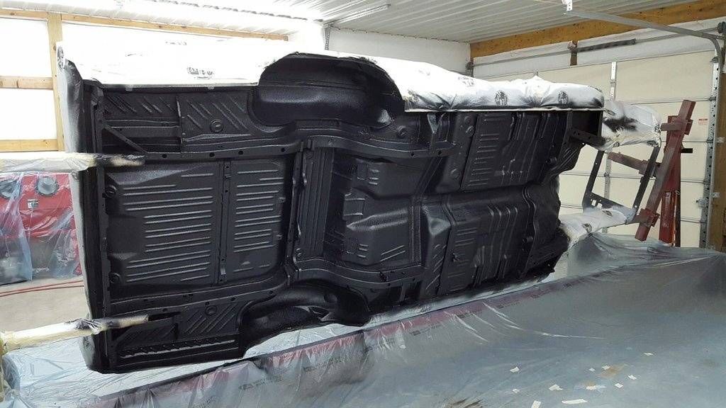

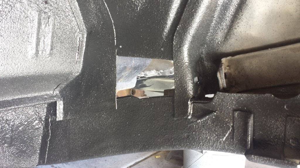

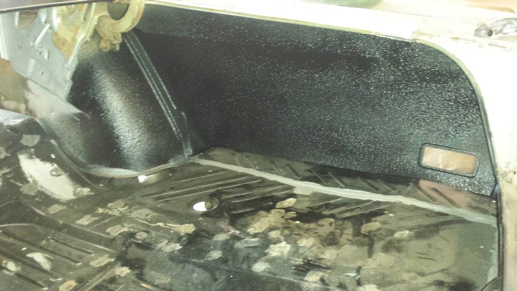

I sprayed mine with U Pol Raptor Liner. It came with a gun to spray it and ended up looking close enough to the factory sound deadener. I also used it in my wheel houses and underneath. I think it helps.
Threewood, do you have a closeup picture of that Raptor liner? it would be nice too see a real example of that product.
HR 20
Thank you threewood... those quarters turned out real good...almost like factory. Good job .
