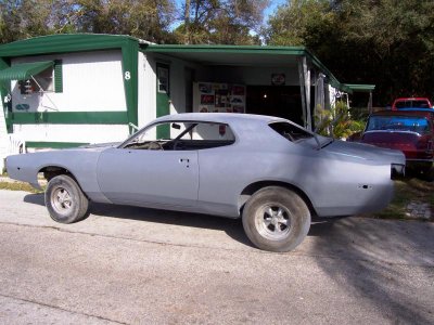

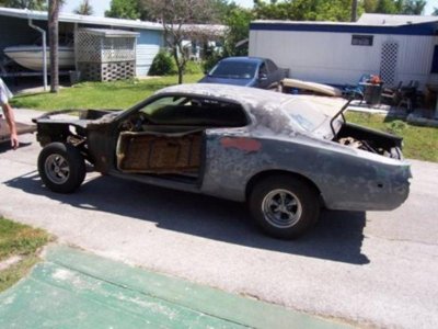

louis charger 001.jpg102_2672.jpgCongrats on your project and welcome to FBBO my son and i have been rebuilding a 73 charger for the last 21 months we started with a rusted pile of dissasembled car. I had no welding,fabrication,bodywork,painting experiance i watched a lot of tutorials on you tube between that and just doing it using common sence the damn thing has come out pretty good for my lack of knowledge. Started with the first photo and the second was 2 weeks ago in sealer, we just sprayed feather fill today [no photos yet] we just finished an hour ago. You will get other answers here and watching the tutorials you'll be able to complete the task.
