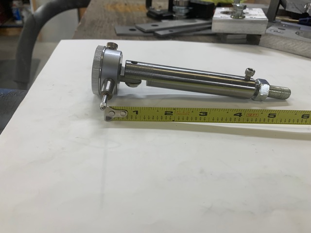

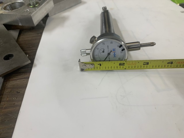

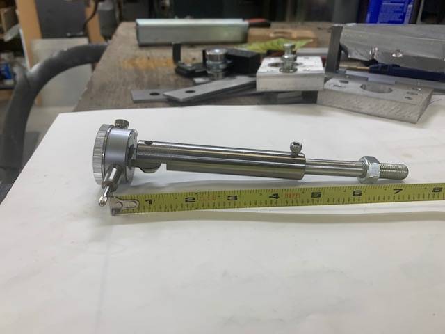

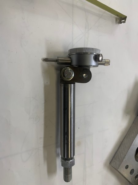

The dial indicator mount I made for this job a few years ago, it screws into a flywheel mounting bolt hole.... Screw it in & lock the nut down, it doesn't move.... Then set the depth and lock that setting...
