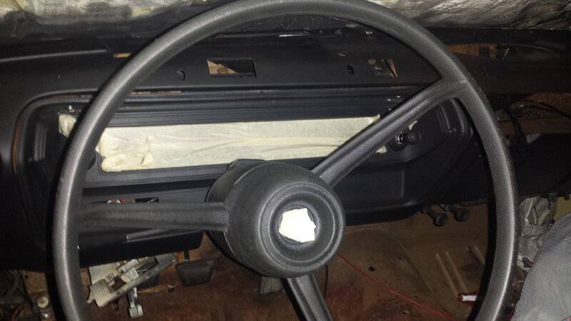

Okay, in "72Dash1", you can see how the glove box door is latched, but doesn't line up with the frame of the dash at all.

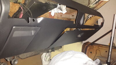

In "72Dash2" to the left of the steering wheel, you can see how the cluster bezel fits into the upper left corner, but the center of the bezel at the top kind of bows down, like the hole for the cluster is too small for it, or the dash frame is pinched somewhere. I apologize for only getting 2 pictures, it's dark in my garage and with the camera flash, most came out blurry or focused on the wrong area. If you want me to get a specific angle or area, please let me know.

glove box lid must be fitted over the box liner, so there is the reason why doesn't align. Once liner is installed, the lid hinge got its holes elongated to a propper aligment. Striker must be aligned after that.
Ashtray gets also some play on holes for screws to a propper fitment
cluster... I think is more about the plastic bezel being curved than the frame.
You don't have problems with the dash frame really
Hahaha, it figures it'd be something simple like the glove box liner. All of that makes sense- thank you so much!
I don't believe the bezel was curved before, but I'll see if I can massage it. Do you have any suggestions on how to un-bend it?

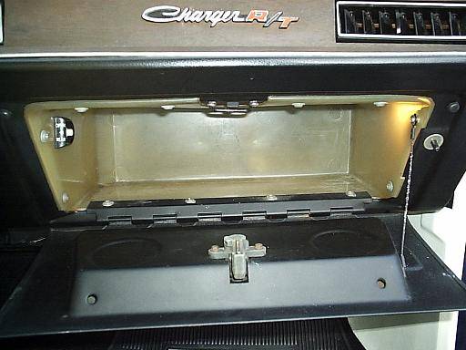

about the glove box... here is a pic of my car one, so you can see the hinge over the liner box. That will raise the lid to the propper height location, then play with the hinge holes and screws.
about the bezel, I don't know, But I bet once dash pad is installed that won't be noticeable. You can allways replace the bezel too. Standard cluster bezels uses to go for cheap.
ALTHOUGHT I think you could be able to get the bezel at the sun since we are on summer, over an already heated surface, and get some weight over it for a couple of days. Dunno, I'm just thinking out loud
