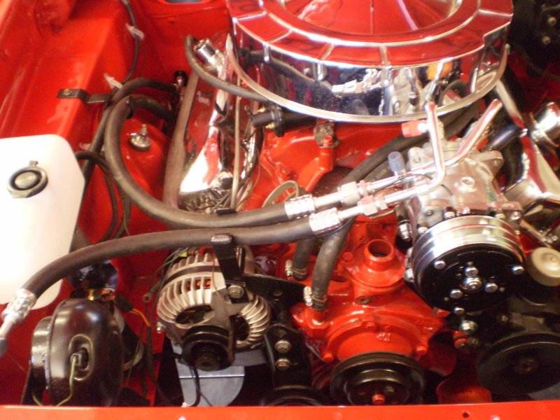

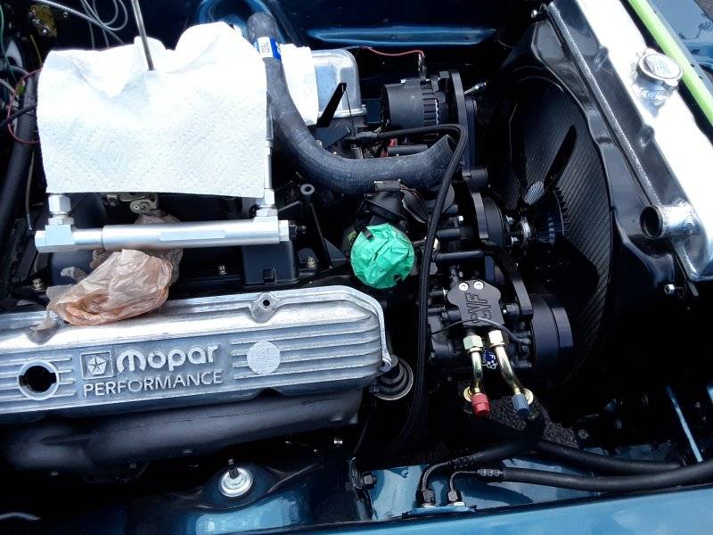

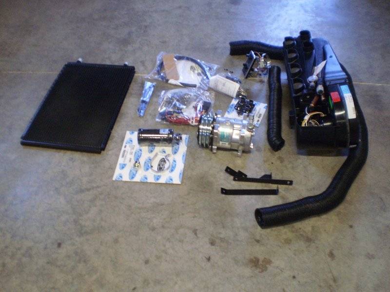

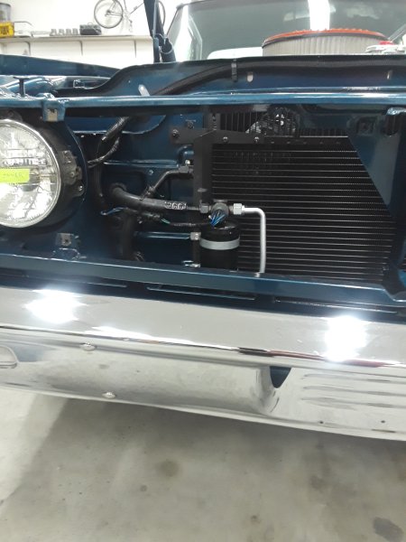

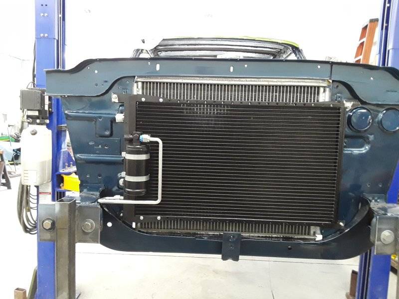

I installed Vintage Air in my 1964 Dodge Polara, which is pretty much like your Coronet. Like you said, nobody makes a kit for the early B-body. I don't like how the hoses are routed in the kit, out through the inner fender access hole and over the front passenger tire. I went through their catalogue an kind of noodled up the parts I needed.I worked with their distributor here in Ontario, Horton's Hot Rods, and got everything I needed. I have everything installed, but have not charged it up yet. That will be a job for next spring. The way I installed it, I kept all the hoses inside the engine compartment for more of a factory look. I posted a lot of pictures and comments about what I was doing on the 64's only thread. If you are serious about doing this, PM me, and I can come up with a list of the parts I bought.

My engine previously had A/C on it with Chrysler's big V-2 compressor on it. So, this gave me a 4 groove pulley on he crankshaft and the special brackets for the alternator needed for A/C setup. Also special pulley and tensioner pulley for the water pump.
The belts on the 2 rear grooves on the crank pulley are meant to run the A/C compressor and alternator. The newer rotary compressor should not be as hard to drive as the original one, so I am going to try running it with just one belt, leaving the rearmost groove empty. The belt on the next groove runs the power steering pump only. The belt on the front groove runs over a tensioner pulley to drive the water pump.

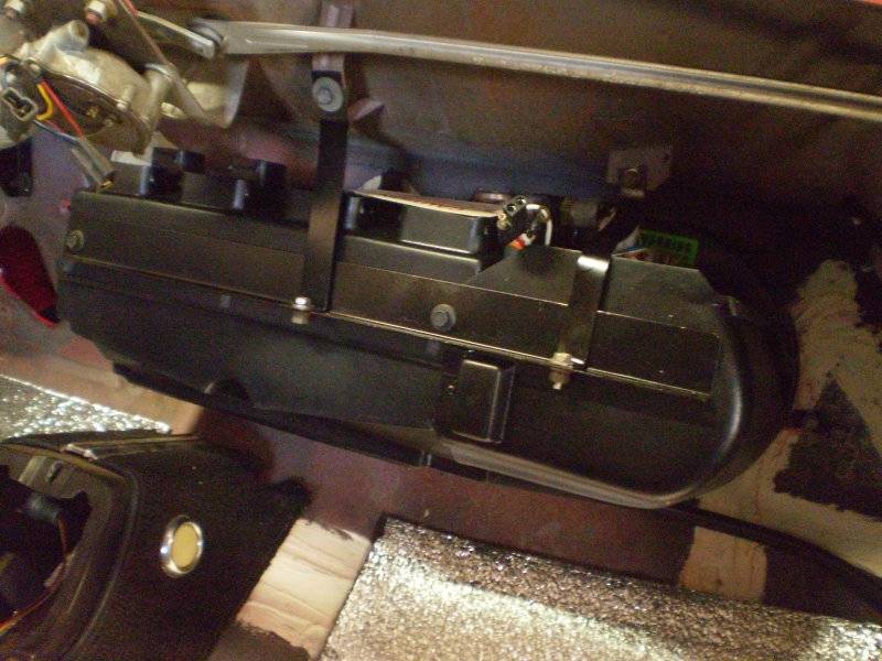

How big is that box under the dash, I can’t find measurements on vintage air website? What made you pick them over other companies? Like Auto AC solutions?
If you go on Vintage Air website, they have a page that gives measurements of various boxes. One deciding factor is that VA has dealer here in Ontario (Horton's Hot Rods). Paul was very good to deal with.
