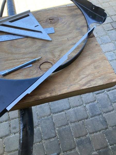

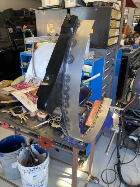

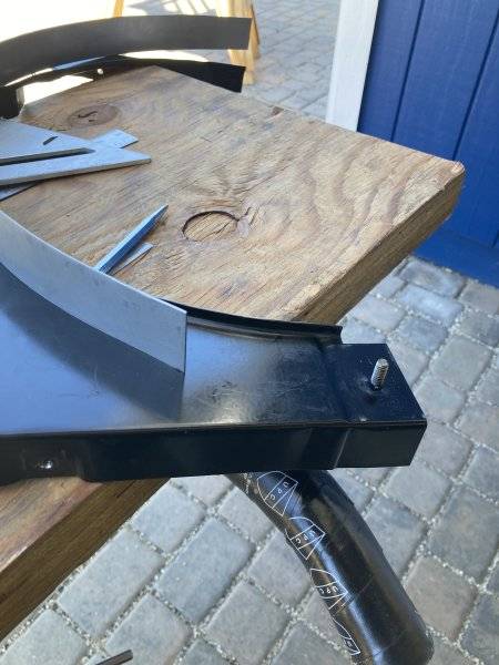

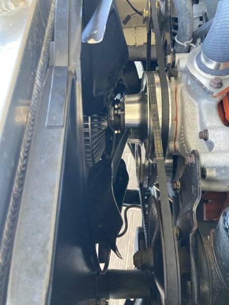

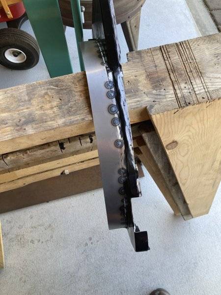

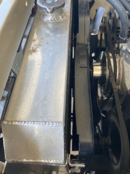

On the wagon I recently purchased, the PO put in an aluminum radiator which is thicker than the prior one. This made it necessary to put in the 2947? Hayden shorty clutch to pull fan/clutch away from the radiator. Have good gap there. However...the fan is way too far out of the shroud. He cobbled the shroud mounting as the radiator had no provisions so there is a large gap between the two units there also. For some reason the blade tips got modded too. I'm in the process of correcting the shroud issues by adding some metal to it to get the fan in the hole and close up the gaps. I'll be on the hunt for a fan too at the Spring Fling next weekend.

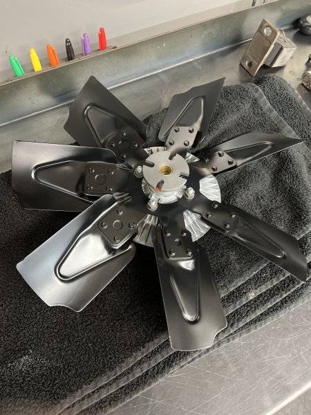

BS do you remember what make or part # that was? looking at aftermarket fans and some don't look great.. gonna use one with a hayden short clutch..
It was a Six Pack/HEMI fan purchased off eBay
