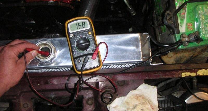

I put a water pump lubricant in plus the "wetting agent" as extra protection with reverse osmosis water. I also test my systems out for Electrolysis by dipping the positive end of voltmeter into the fluid and ground to the body.
You should have less than 300mV (.3 volts) in your coolant system. Test with a multimeter ground and one side dangling in the coolant.
Over 300mV and you have an electrolysis issue. That comes from:
  • worn radiator fluid
  • stray voltage in your electrical system making a path to the fluid (bad grounds)
  • electricity built up as fluid passes over dissimilar metals
The picture shows my system at 76 mV (.076 volts)
