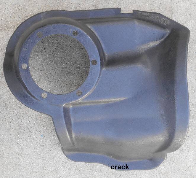

Need to freshen up my "Turtle shell" and am curious what Plastic paint you have used with a great level of success, what level of gloss you would recommend, etc.? Any help much appreciated. Mine is bit rougher than the one in the picture but grain is good, etc. just faded, dirty and discolored in some areas.

Thank you everyone for the suggestions. Anybody have any results to share? Also, the turtle Shell as its called is in the picture above. It is actually the three speed console in 1962 for a T-85 3 speed car. Yes, they spared no expense back then! LOL.

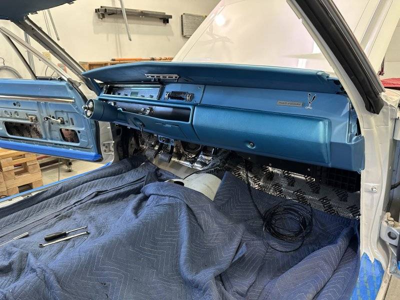

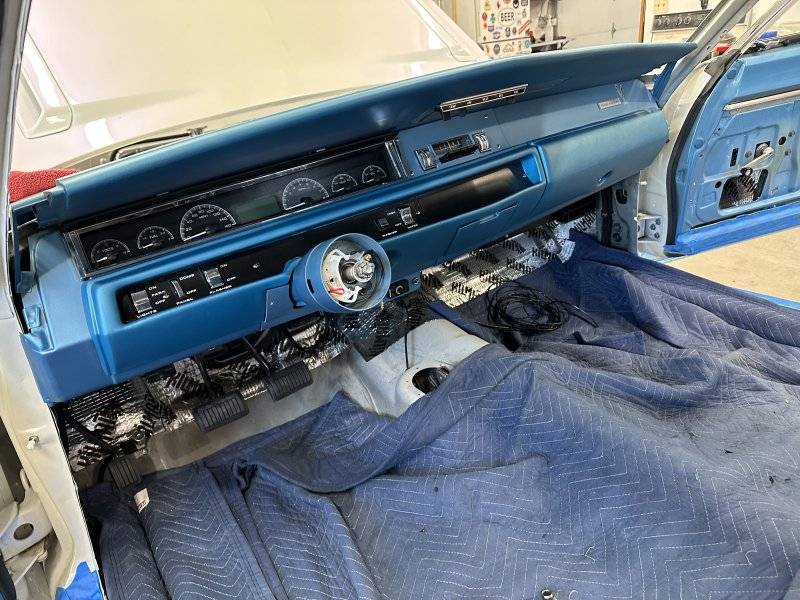

So it's an interior part? If so, go with Herb's. Herb's on the dash pads below. Will use it on my hard plastic parts as well. Two different colors on the dash and pads by design. Subtle but i like the contrast.
