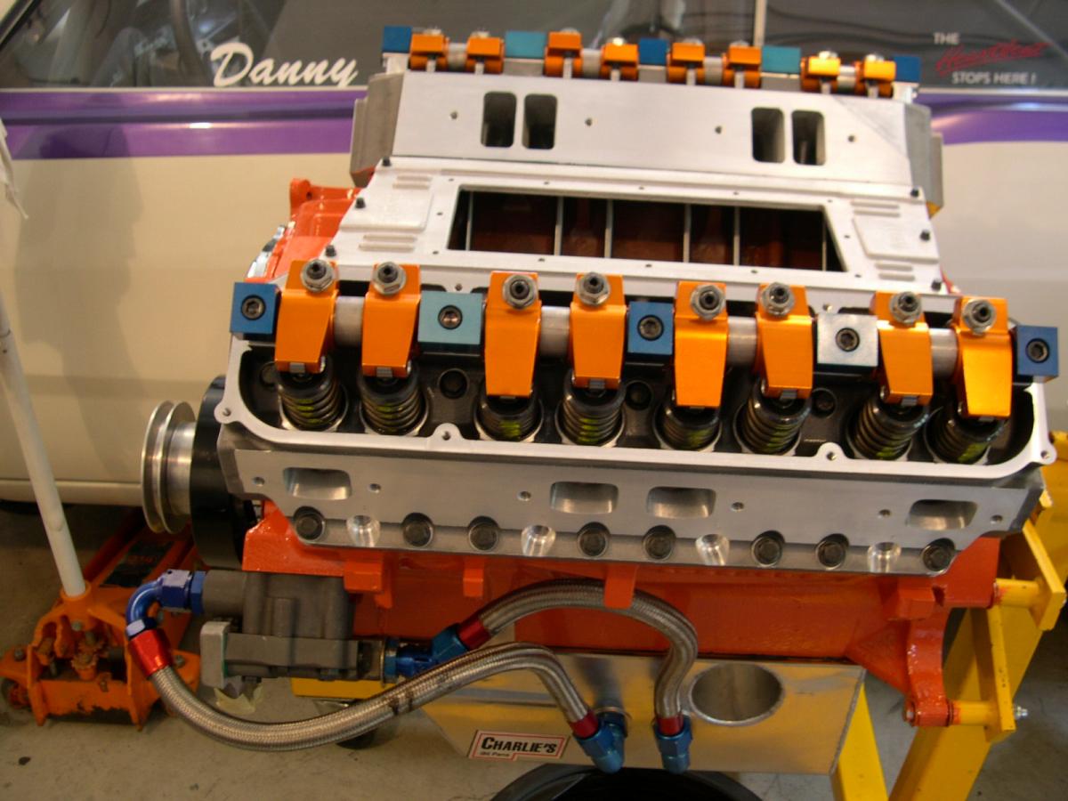

I put a set of $1200 T&Ds on my 440 with Indy heads, after breaking some cheap Indy aluminum rockers ... If you are running a set up with a big cam and high pressure springs do not cut corners on the rockers!

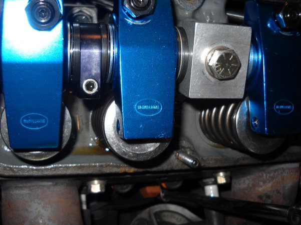

As long as were talking rockers, anyone ever heard of McWilliams Rocker Arms? I'm running them now and seem to be working OK. I got em from a friend who knew a guy that had an uncle that traded a horse for 'em:icon_biggrin: They look similar to crane with no rollers or bushings on the shaft. I don't find any info on the the web. As long as they stay together, I'll keep running 'em...

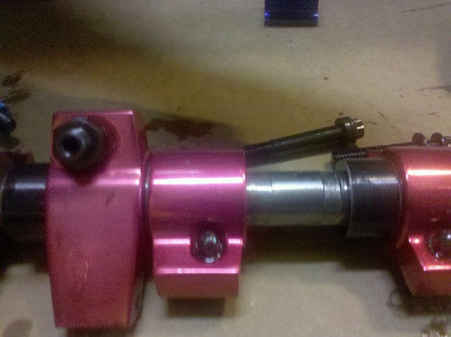

I'm not trying to bash 440Source (I've used some of their stuff with no issues) but I had a bad experience with their rockers. I went with their roller rockers trying to save a few bucks on my last build. After maybe 100 runs, the rollers ate into the shafts. See the attached picture. Of course the metal went all through my engine and when I freshened it up over the winter, the bearings showed signs of dirt (i.e. rocker shaft material). I ended up buying Harland Sharps. Like I said, I don't want to beat up on 440Source. They do have some great stuff. The rockers just didn't hold up for me. Maybe for light street duty they'd be ok...

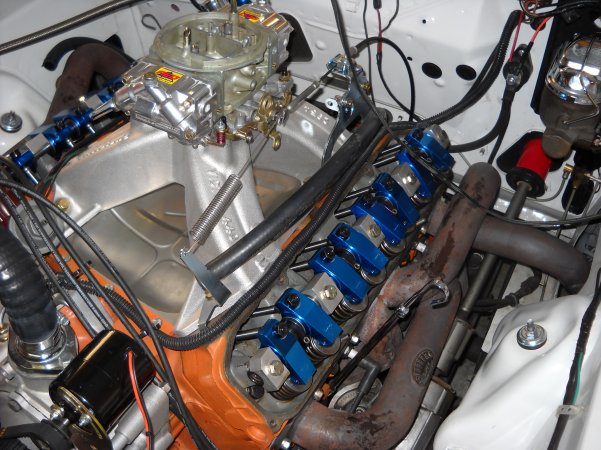

Harland Sharpe
Harland Sharpe- same rockers on 3 different motors and never a problem, never backed off......
