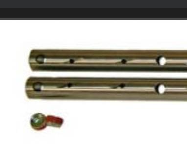

Hughes is what I've been using on the last couple builds..they're holding up very well with my setup, still looked brand new on a recent R&R but my springs are only about 430-ish over the nose. They're heavy wall shafts with the 'banana' grooves and the ends are threaded for screw-in plugs.

I too have been running the Hughes shafts with good results.... Thick walls, Banana grooves... Not cheap but good quality..
Same here have been using Hughes shafts in my eng since 2011. Still going strong. Ron

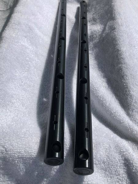

Bought these: https://www.ebay.com/itm/264431126226

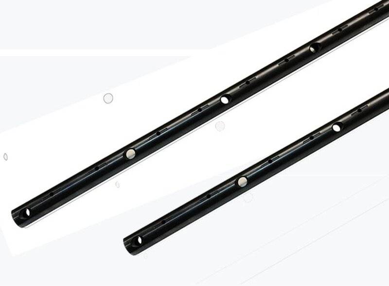

The difference in oil grooves is interesting. Chrome shafts has none( as far as I can tell)?
The ebay ones look identical to mancini HD with a straight oil groove and end plug.

and the banana grooves are pretty unique.

FWIW the Hughes ones have extra thick walls so they don't deflect and a tapped thread for a plug so removing the plug the clean inside the shafts is easy... Think cleaning the inside of the shafts isn't a big deal? Well if everything is happy you'll never need to clean the shafts but have the misfortune to lose a camshaft & suddenly it's damn important.... Cause debris will get in there & if you don't get it out it will come out on it's own and find something to destroy...
I could definately see that..I had to correct post 9. Hughes looks like the best way to go. I like the banana groove better then the Mancini's straight groove.

I think that the Hughes grooves are done by hand whereas the Mancini/Ebay (= Stanke Motorsports) are machined. Both types are thick wall and have removable end plugs. One difference is the coating: Hughes is chromed, Mancini is melonized.
