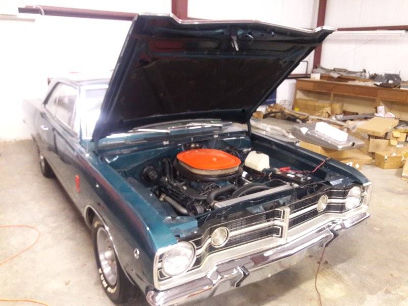

ng story short, they work. I'm using a set on my 68 Dart with a 451 stroker and a 6 pak.

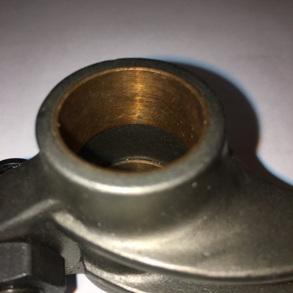

I wouldn't say they're "garbage" HOWEVER keep a few things in mind ... the Cranes are an iron piece with hardened tips. I have seen MANY with significant wear at the valve end - rendering them useless. And once they start to wear there is no stopping it from getting worse. Also, they are not a bushed rocker so there is a greater tendency for them to gall both the rocker and the shaft. The Iskys with the hardened valve tip inserts would be a much better choice if you had a choice but they have the same non-bushed issue. Next is the price. I don't consider $250 a very good deal for these - even if they were brand new. There are some better choices out there - brand new for not a whole lot more money. This for example is an iron rocker, adjustable, roller tip AND bushed bore. Hands down, a far better choice.
