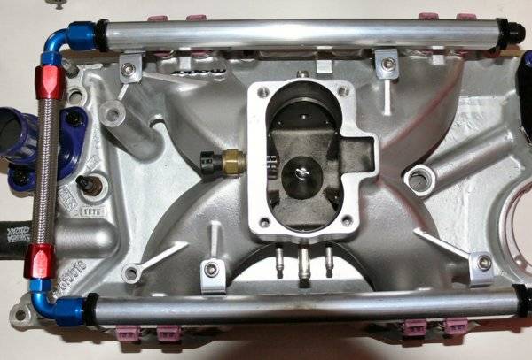

They said the torker 383 had minimal loss of low end torque even though its a single plane intake. But I wonder if it was fitted with a turtle kind of like you would do the mopar M1 intake to help with fuel distribution would help bring back that low end torque loss. Just realized that the Magnum intake pictured below would not be distributing fuel but air flow. But would the turtle help with a carb? Not real sure now that I think about it.
This is a Mopar M1 intake for a magnum 318 or 360 but the idea is the same. Center it in the floor of the intake.

Ok now I’m lost! Never heard of these “turtles” before.
Basically helps direct airflow to the runners rather than crashing in the flat area of the intake. Check out the bottom link in my post from the Brodix website.
This is a quote from that page.“Turtles” are cast aluminum manifold inserts designed by Jean Dittmer and manufactured by BRODIX®. These inserts fit in the bottom of an intake manifold to direct the flow of air and fuel mixture to increase horsepower, torque, and driveability."

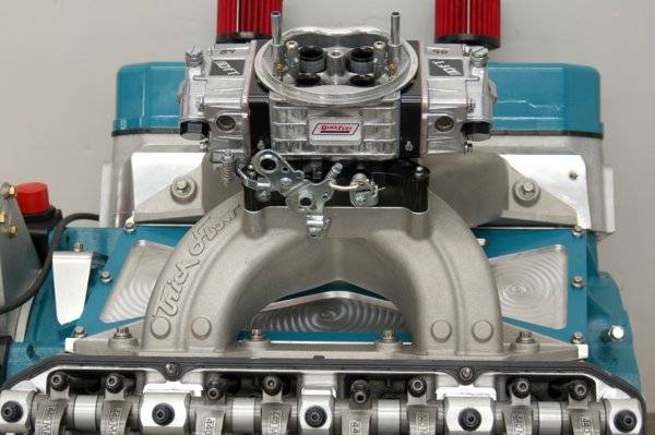

The new Trick Flow intake is the best one on the market. You can make it even better by port matching. I've also found that the Mopar M1 4500 is a good intake once it is ported. I've been testing low deck intakes for the past year on my 470 dyno engines and have posted a lot of articles and videos. Here is one from Hot Rod: http://www.hotrod.com/articles/test-intake-manifolds-carburetors-440-stroker-search-ultimate-power/

You are correct, the Torker is an outdated design. The Edelbrock Victor intake is better than the Torker for making power but the Trick Flow intake is even better than the Victor. No reason to run the old designs unless you're flat broke and have to use a swap meet intake.
If you are shooting for 600 hp with the 240 heads then you'll want to run the batwing gasket holders to get the port alignment perfect. The standard tin pan gasket won't have the port locations perfectly correct for the 240 heads which will cost you some power.
