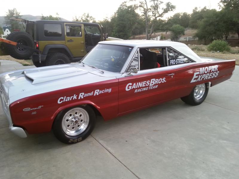

View attachment 276374 russell lines.jpgWell, I get my car back Friday as the Dana 60 Install will be done.
I need input on you guys opinions on best slick for best 60' times.

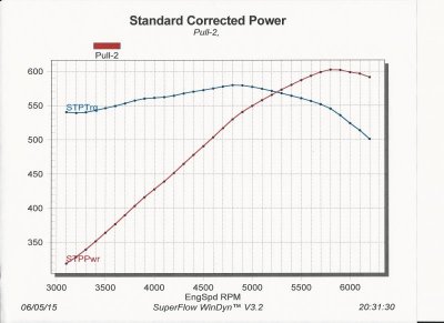

I have 605 (dyno) horsepower...505" inch
5200 flash converter.
I will leave at 2500RPM off my Footbrake off the MSD 2 Step with the gas pedal matted.
3650 lbs
Moroso DS2 28" front tires and 5 1/2" front wheel travel with Cal Trac 90/10 Frt Shocks
Cal Trac Bars with Cal Trac Monoleaf springs and Cal Trac 9 way Adj RR Shocks
Narrowed Dana with 4.30 and Spool
15X10 Weld Wheels
I am currently running a brand new set of MT DOT (4 groves to make them street legal) Bias Ply Slicks 28x13.50x15, 11" wide
I bought those slicks to be able to run "street legal" classes but dont know if they will really "hurt" me with my 60' times. I have had some guys tell me they are a crappy tire but I dont really know.
One NHRA super stock guy told me to run 9" Hoosiers on my 10" wheels as that is the new "trick" setup...duh...I just dont know.
Your thoughts.??528.jpgScan0005.jpgView attachment 276373

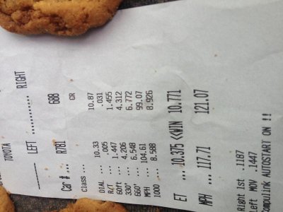

IMG_0099.jpg this run was on goodyear 30x14 wide slicks car 688 the cookies from the wife holding down my tag for a photo.

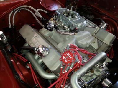

Mike...... my build has some common features with yours:
440 block with Eagle stroker kit and Mahle pistons for 505 ci. and 10.7:1 CR
Comp custom grind solid roller, .640 lift, comp roller rockers
Indy EZ heads ported to max wedge size by Modern Cylinder Head in Michigan
Eddy Super Victor Max Wedge intake and 1050 CFM Quickfuel Dominator style carb with full air cleaner.
727 manual valve body trans with 4000 stall convertor
8/3/4 rear end with Strange axles, mopar performance aluminum centre, and detroit locker posi. (Dont sell 8 3/4 diffs short...this one has been dealing with over 650 hp for quite a while)
SS springs and Caltrac bars
Viking DA shocks in front, Rancho SA shocks in rear
M/T bias ply W series 28.1 in drag slicks
4 wheel manual disc brakes, manual steering, lots of suspension and steering upgrades, handles quite well.
I tried Hoosier radial drag slicks and CANNOT get them to stick....I blow em off every time..
Any thing else I can help u with, please ask
Splicer
