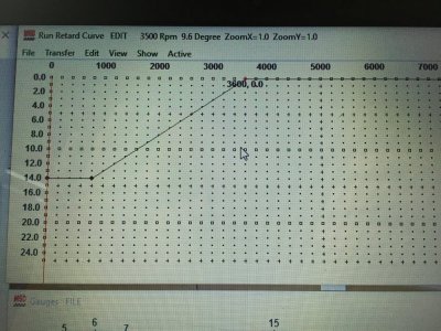

So I'm right in the middle of swapping the stock igniting in My 71 RR for a MSD 6AL2 Programmable unit. And I need to make the advance curve with the provided software because it doesn't come with a pre set curve. Picture attached is what I've come up with so far... I was thinking I'd set my total timing at 34 degrees and pull out 14 (so timeing will be at 20 degrees at idle) and start the bottom of the ramp at 800rpm and straight line it to 3600rpm where it will be at the total timing 34 degrees. Thoughts?
My engine is strong running 383, 10.5 compression, .477 .480 xtreme energy cam, ported 906 heads, 750 quick fuel with mechanical secondary's, dual plane mopar performance intake manifold, 1.75" long tubes and dual 3'' exhaust, 4 speed and 391 gears.
This is not a scientific answer but I'll go ahead anyway. Back in the day we used to put in as much aggressive curve as it would handle. We would use the engine knock to determine that. Obviously, depending on the fuel octane we would simply back it off until the engine stopped knocking under hard acceleration.
On a more serious note. Have some fun. Since it's programmable, take it to the track on a test and tune night. Your results will be right there on the time ticket.
Would like to see a chassis-dyno report on your motor.
That's probably a good starting point. If you don't have any knock on that setting, I'd try bumping it up a little above 3600 until it either starts knocking or starts getting slower (depends on fuel). Once you get that bit right, then you can start playing with it below 3600 til you get best driveability.
Or vice versa, if you street drive more than race. That's what I would do anyway. Does it have any provision for vacuum (IE does it have a map sensor)?
Thanks for the input guys! Finally got it up and running yesterday morning and its hard to believe the difference in drivablity at low speeds and idle! I'm happy with this timing curve so far but she doesn't seem to have the same pull above 4000 so I'll bump the total timing up to 36 and try that.

Also, if it runs good like it is up to 4k then feels flat, I'd almost say leave it at 34 to 3500 then start ramping it up to 36 at 4k, maybe 37 at 5k. It doesn't necessarily have to be a flat line...
Thanks for the input Force Fed. I did what you suggested with the ramp and then bumped it up to 36 total and kept the initial at 20 and what a difference! I saved another 4 degrees of advance on the box so I have that much adjustment without having to move the distributor when I get it on a dyno for fine tuning!

On my msd 6al-2 6530 I have my initial at 46, And I pull 24 degrees out at idle, have 36 degrees at zero boost and zero vacuum, timing starts dropping less than 36 into boost, and raises above 36 at vacuum. I have all my timing in at 2400 rpm, I think your should try ramping up your timing earlier. I am using an msd 2 bar map sensor. My engine likes having more timing under vacuum, I would recommend a map sensor and trying it, most defiantly with a street car.
