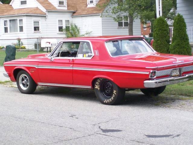

This is a 65 B-body rear I put in my 63 Sport Fury. Fits great. Ron
