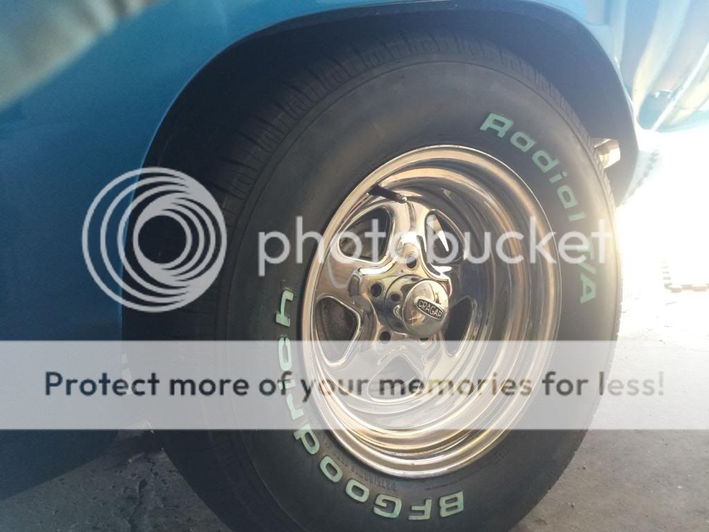

I need new tires and have 215/65/15 on the front and 265/50/15 on the back. I don't see that they make 265/50 anymore in this tire. I like the raised white letter look. I have Magnum 500 rims but I'm not sure of the rim width. I am assuming 15x7 but is there a way to tell w/o removing the tire first? Will 275/60 fit on the rear? How about 225/60 or 235/60 on the front?

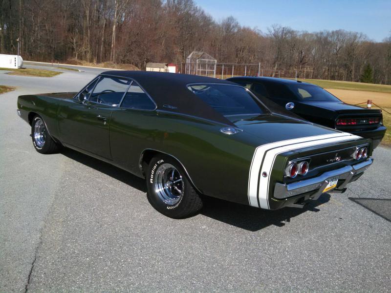

I put 245 60 R 15s on all 4 corners of my 68. When I was deciding on tire sizes, I put 275 60 r 15's off my challenger onto the rear. They fit without issue:

Thanks, No creativity on the backspacing at all I got the 275/60/15" tires, 8 inch rim with 4 1/2" backspacing and I narrowed the axle 9/16" on both ends to make them work without moving the leaf springs or modifying the fender lip. I did have to buy Yukon chop axles and cut them down to the proper length. It was well worth the little extra work involved.
