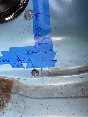

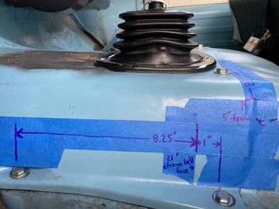

I took the measurements off a 67 b body shifter location and transferred them to the inside of the truck.
The distance from the face of the bell to the shifter centerline is 21”. Inside the cab that is 1” forward of the back lower side tunnel cover bolt centerline. It is 8.25” back from the centerline of the middle drivers side cover bolt.
The offset from the centerline axis of the transmission to the shifter centerline is 5”. From the top drivers side bolt on the tunnel cover to the shifter centerline is 2.5”.
The pictures should help.

Wow! Thanks for that, let me ask you this, the trans and shifter in your truck (pictured), whats that out of? Is that an A833? Also the shifter in your B Body (which the measurements were from), does it mount to the front of the tail shaft or rear?

The A833 shifter I took measurements from is on the front mount of the tailshaft. The same position as all 66-70 b bodies regardless of buckets or bench.
Just from the looks of my measurements it appears my measurements pretty much line up with your current shifter location.
Let me know if you need anything else.
