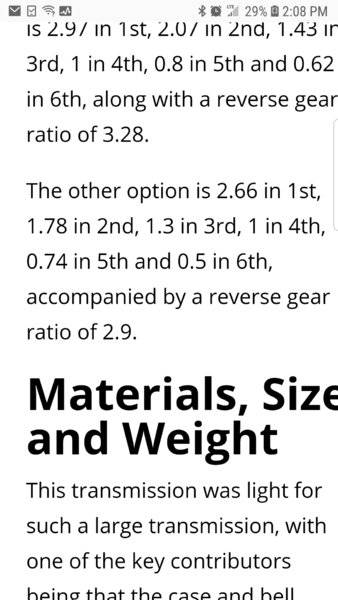

Here's the ratio's for my T56, love them but 6th is ridiculous. Perfect 5 speed gears with an extra gear souly for high speeds.
