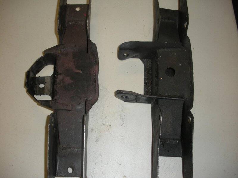

Are you getting the TKO unit? I've installed 4 TKO units in E bodies which will pretty much be the same as your B body. The main thing is getting it in high enough for proper driveshaft angle. Had to notch or dent the crossmember and dent the floor in a few spots. Nothing major. Also there are couple big tabs on the tranny that you can cut down for clearance.
Which bellhousing are you using? Quick Time or American Powertrain? I used the older Kesler housing on two and the Quick Times on the other two. Quick Time says that you don't need to index their housing. I've also used their housings with the 833 twice and never indexed them. I've never used the American housing. Are your using hydraulic or mechanical clutch- throw out bearing setup? I've used both.
This TKO is based on the Ford unit so that might help with the speedometer setup.
The two things I don't care for about the TKO is they don't shift nearly as well as the 833. The other is that the Mopar shifter sits clear back on the tail housing and you have put the yoke hanging out about an 1" further than normal so it doesn't hit the shifter while in 1st, 3rd and 5th gears.
Other than that you'll probably really enjoy having it in your car.
