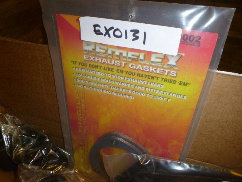

Remflex have an excellent rep, but also noted for being fragile during install.
Ive always used mr gasket header gaskets on my headers.
Remlex is best.... just don't plan on being able to re-use it. They are worth the price!

Remflex is good. So is Cometic (which I use now). Pricy as heck, but multiple uses hasn't
stopped them from sealing every time.
Hey guys! Thanks for the recs! I will mull all this over and pull the trigger on something tomorrow. Where are you guys sourcing the Remflex gaskets?
I went with Remflex 6002 from Amazon- I never would have guessed they were the one to go with if not for y'all recommending. Thank you Thank you!

I took blown out gaskets off my Dart... they have TTI embedded in them. Why I went with Remflex. The smart man in me keeps fighting the frugal one and keeps telling the smart one to throw the headers away and get some stock 340 manifolds!
Tried them all (almost) over the years. Remflex on Amazon. Buy 2 sets and be careful with them easy to break as said before.
