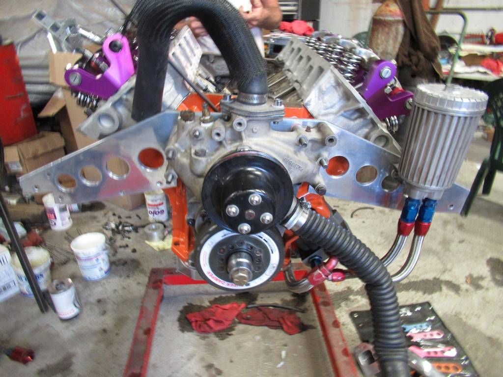

Mopar Performance with an A/C water pump.

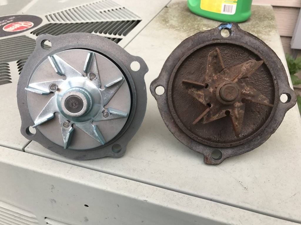

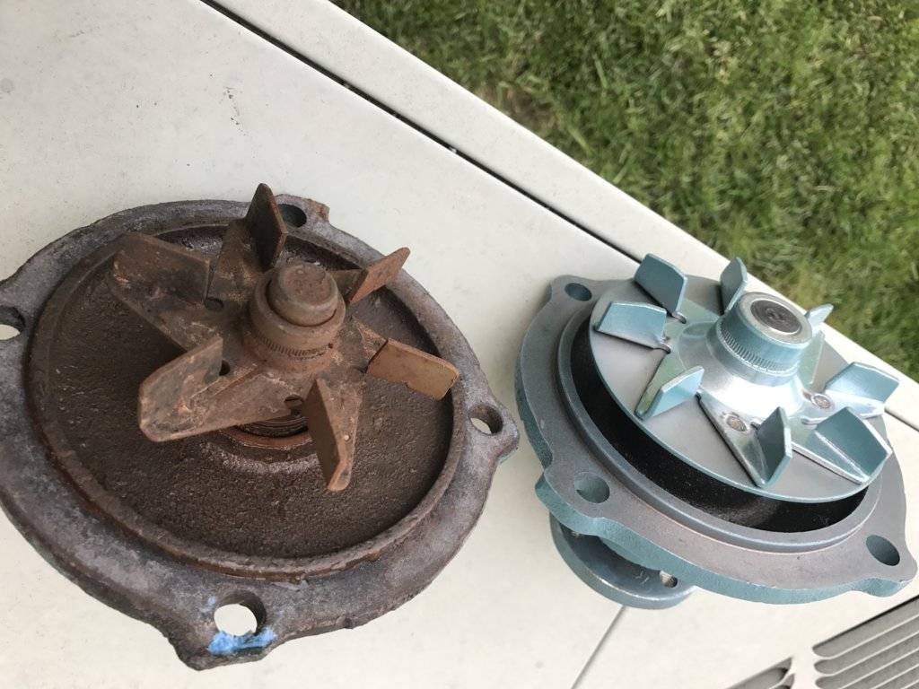

I recently put a Summit Racing Cast Iron Pump into my Satellite and am very happy. It's a 8 fin design with a back plate to help channel the flow. The housing has a cast look and once I sprayed with some engine paint you'd be hard pressed to tell the difference.

The reason I like the MOPAR aluminum is the aluminum dissipates heat a little better and the a/c pump has a few more vanes.AND,,,,it's lighter!

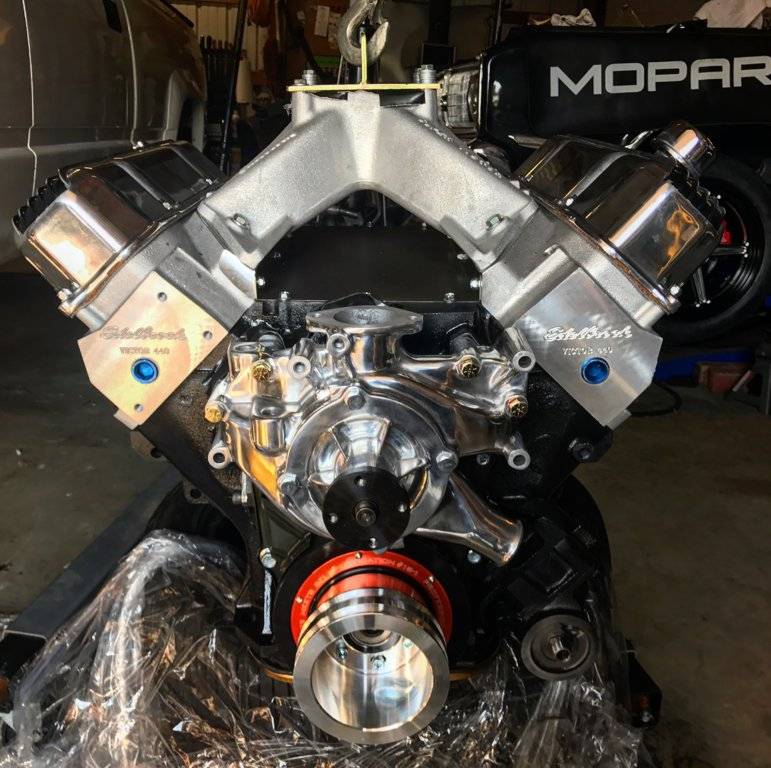

I got one from 440 source, don’t know how it works yet but looks good
