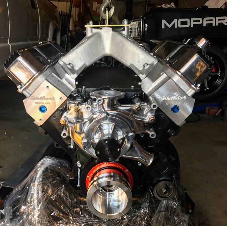

          My 440 source pump and housing work great.

              Yep. Thus far I have a zero percent overheat rate. Calculated that all by myself.
