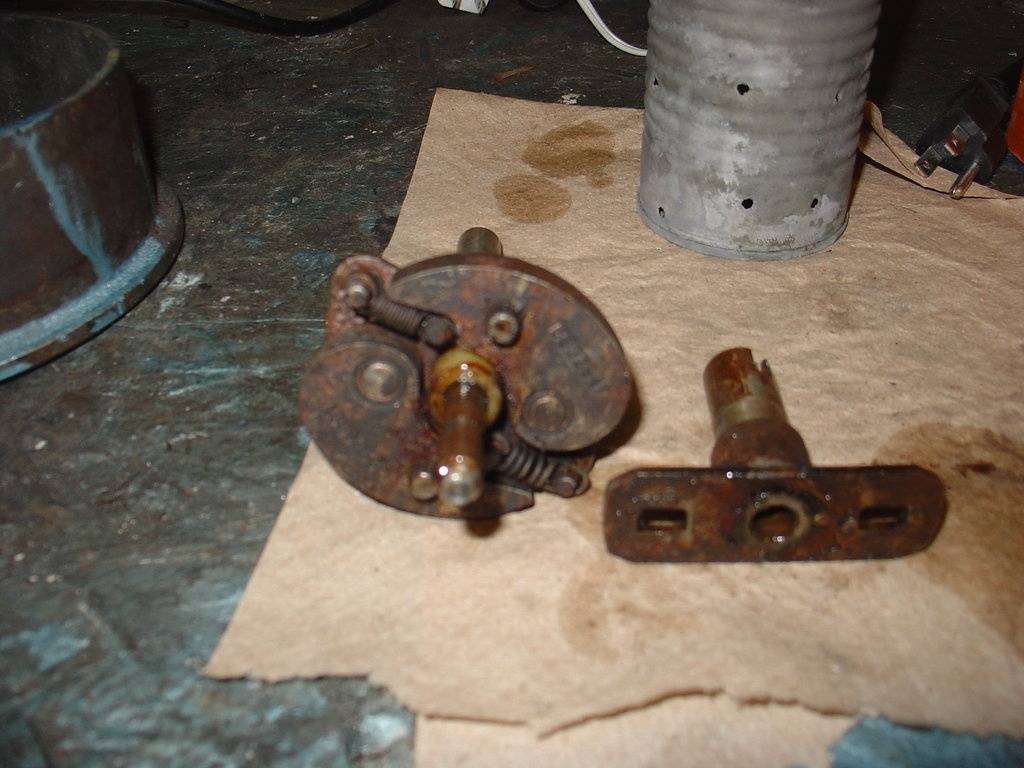

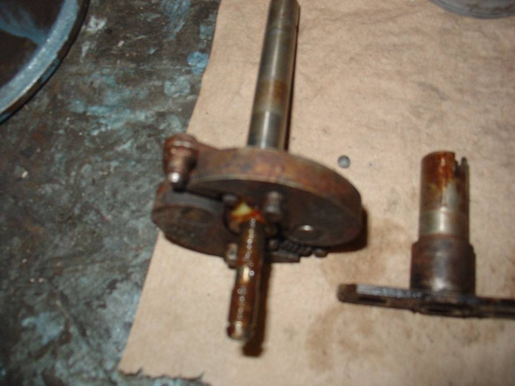

No one ever oils the advance cam, and this is the results.
You mean like this,usually because 75 % don't know how to get it apart .

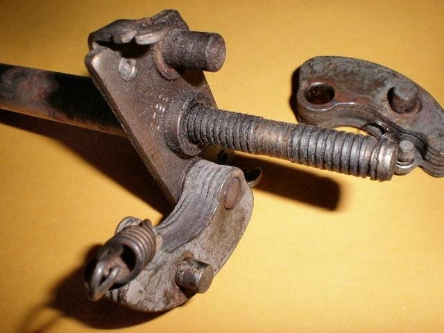

When it could look like this .
seems like i always have to take my distributors apart a re-lube the advance weights. what's a good lasting lube?

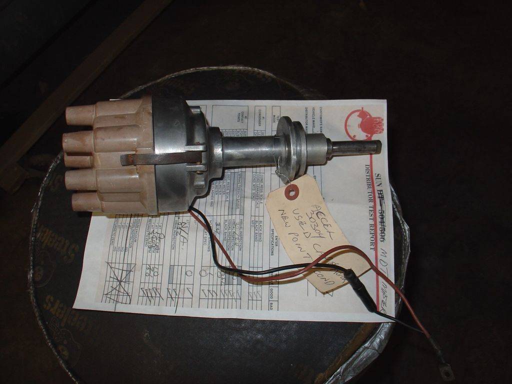

I KNOW I HAVE A 20302 READY TO GO. 150 AND THE RIDE?
